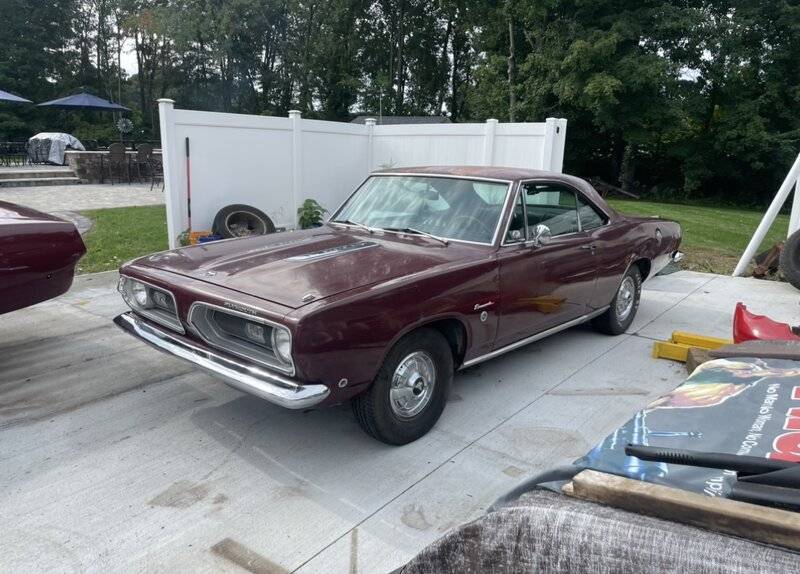

68 Barracuda 225 to 440 to 426

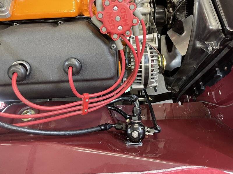

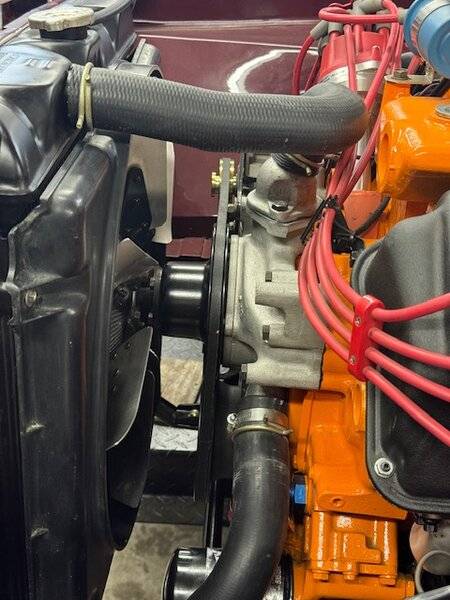

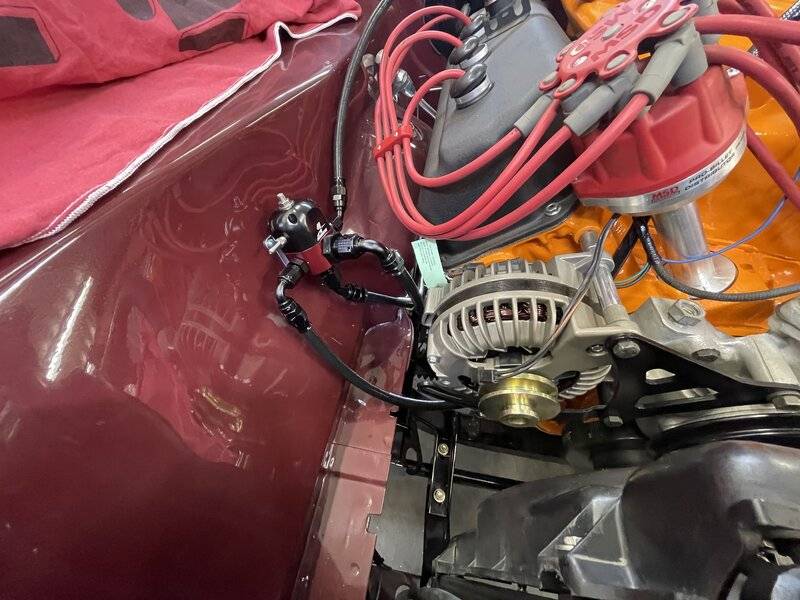

Your project is over the top , looks great . Many years ago I had a 67 fastback I put a 426 Hemi in, this was way before any of the great kits were thought of . I just wacked off the hemi mounts off of a 65 hemi k member and set the motor in place and welded them in .Found a set of the factory headers from a wreaked SS dart and massaged they in place . Things were so much cheaper back them . I have one thought to pass on to you . Your picture showing the spark plug wires have the small boots for the plug tubes , the big boots were used to keep dirt from falling into the tube and going into the motor when pulling the spark plugs , just thought I would mention it . Hate to see anything get ruined with your project . Anyway great work . looking forward to seeing your progress .
Thanks for the tips. Let see some pictures of your car.

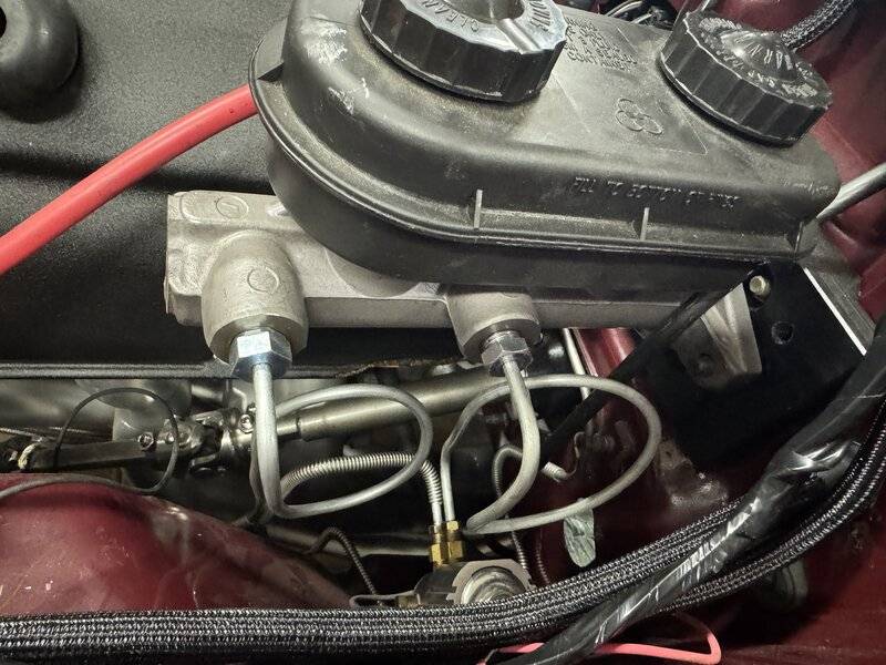

How the heck do you change sparkplugs on that?!!!!!
Jeff
It’s actually not that bad you just loosen up the master cylinder and you are able to move it enough to get the plug out

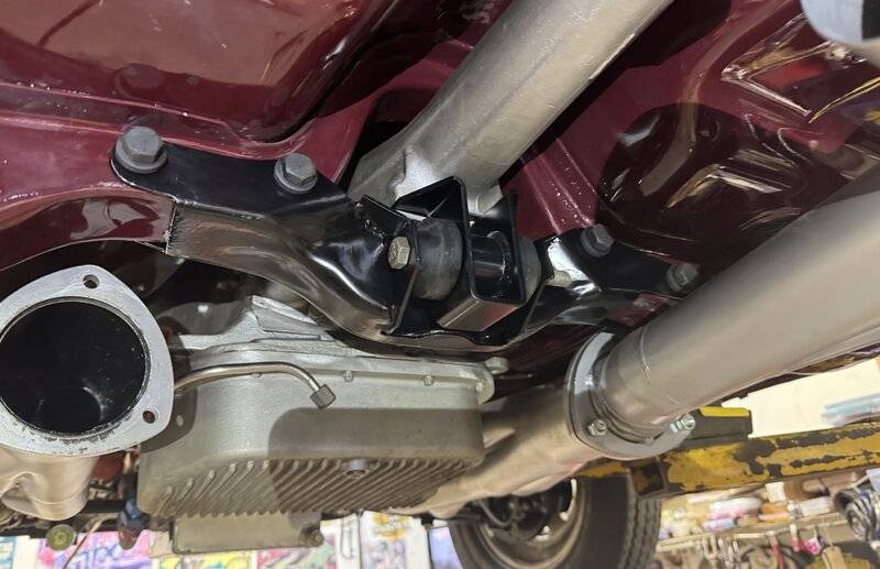

I ended up taking out the original transmission crossmember and installing a 73 one. I like this style.

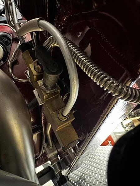

Little more room on the firewall with using HemiDenny’s bulkhead bracket. Very nice.

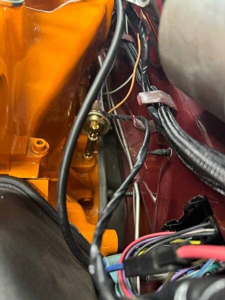

Oil pressure switch for factory and aftermarket gauge installed.

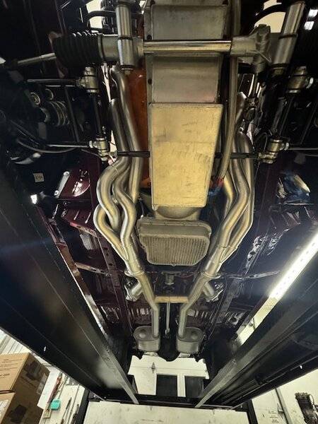

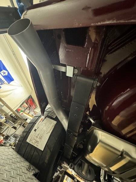

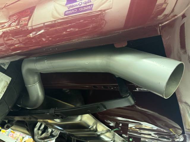

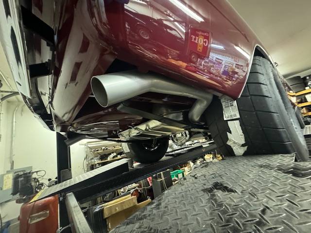

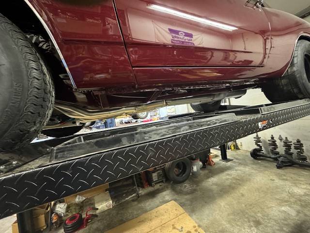

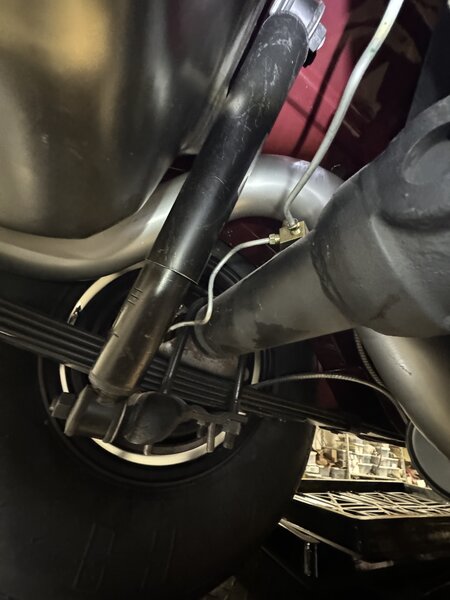

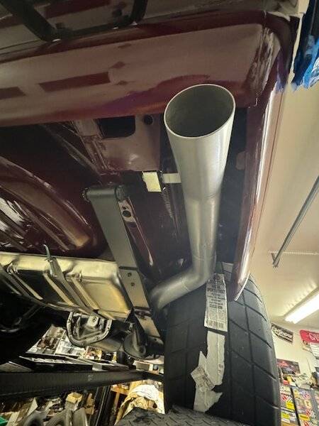

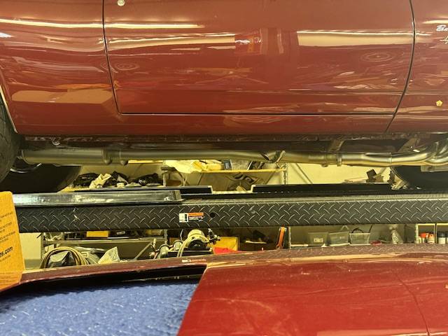

All Exhaust with Cutouts all back in for the final time. It is tight, hopefully no rattles.
just spitballin'.....you are not concerned compressing the rear suspension and crushing your tail pipes?
