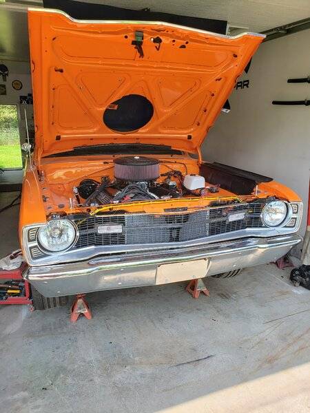

Bought new front and rear AMD bumpers from Classic Industries. The rear fit/ finish / fitment wasn't to shabby but the front was a different story , fitment is terrible due to stamping shape/ bend on the rh / passenger side as you can see in the picture. Its not shipping damage either. You can see where the damage was chromed over . Shimmed it a bunch trying to make the best of it because of my Geography/ Ontario Canada its not economical to try return and doubt very much the mfg or vendor will do anything because of that reason.
