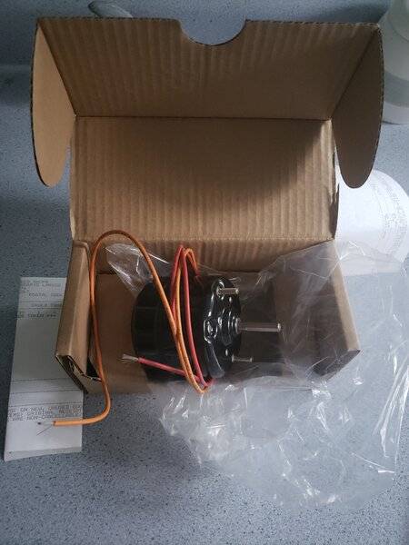

Now that I've got all the new brake lines in and system bled its onto the heater box. Picked up ah451 blower motor for the heater box yesterday. For anyone that doesn't know this is a counter measure for blower motor contact to the 440 valve cover on passenger side.
Fabo member Mark machined a spacer for new motor shaft to tumble fan mounting. Partially reassembled with all new heater box rebuild kit.
Hey, it says "Torrington" on it! Must have been made in my home town at "The Torrington Mfg. Co." Of course, the Airotor division is not here anymore.
Heater box back in , lots of clearance . Now fighting with assembly/ fitment of this retrosound Redondo into the dash / face plate. Not impressed so far with this unit .
