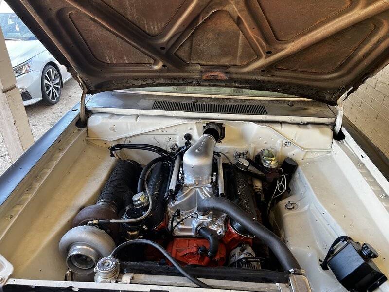

I’ve been sorting out all the new editions and the car is running great…out of boost. The carb is going lean and I’m running out of ideas. Initially it was doing okay running it exactly how it was last year with no PV and 86 jets front, 96 rear. Was still going a little lean(12.5) up top so I decided to try out a front pv to add some fuel. After tossing in a 6.5 pv with no other changes the carb has done nothing but go 14:1+ under boost. The power valve didn’t seem to be opening. Pulled the carb hat off and drove na; pig rich sub 10:1. Pv definitely opening when the hat is off. Put the pv plug back with the same jets as before and still 14:1+. Verified fuel pressure is rising 1:1 with boost, and triple checked float levels. Whatever changed during that power valve install I do not know, but I guess I’ll have to pull apart and clean the entire thing.
Besides that I did some low effort paint so that I would qualify for vastly cheaper antique insurance.
If your power valves are not boost referenced they need to be. Also, depending on which Holley you’re using if it has the check ball for power valve backfire protection, boost can actually force the ball closed and seal off the power valve.
Holley 650 double pumper
I am running vent tube extensions
CSU hat
No check valve
I tried a boost referenced power valve yesterday; no change.
Regular power valve was working when I started tuning last year and should still work since I’m at only 8psi.
What size is your pvcr? Stock or have they been drilled?
Yes they have been drilled by myself during initial tuning. I don’t remember the size, but they’re too big so I plan to re-drill and tap for adjustable pvcr’s. That’s why it goes so stupid rich when the carb hat is off.
Something I read on YB a long time ago may be applying here. Is it possible you’re drowning the o2 and it’s reading a false lean because it’s overly rich? Just a thought.
CSU hat
No check valve
I’m running a Holley 650dp. No vent tube extensions and the spectre hat. After the hanger18 mod I ended using a 6.5 pwrvalve and up opening the pvr from a 60 to a 90 as well as the icr from a 35 to a 53. I have rear PV blocked. 72 front jets and 78 rear. Cheap 044 Bosch pump with -6 feed, return aeromotive boost reference FPR. I can flood it out to a 10.0afr at 10psi with a 2 sizes bigger jet change in rear. Wondering if you have some trash in one of the circuits. You should be swimming in fuel.
Yea sounds like trash in the pvcr circuit to me.
I am the one who had the carb we reversed engineered to come up with the “hangar 18 mod” hangar 18 is my buddy. We took my 750 apart and modified his carb exactly the same. I got that carb from Ak Miller and ran a small block blow through set up in the mid 90’s. The PV orifice needs to be opened up and the anti blow back check ball needs to be removed oht of the signal circuit. The carb hat causes lean cylinders even though the O2 sensor says its ok or rich. You need to be at least 10 sizes bigger on the side where the hat points. Also a single plane intake really help with distribution. This is a cool build, i love it when someone has the guts to take on a project like this and is willing to learn. I cant wait to see what it runs at the track. I had a similar set up back in the 90’s. It ran 10.0s at 133 with 2.76 gear off the foot brake with a mostly stock 360.
Disassembled, cleaned and soaked the whole carburetor; no change. I believe the change in hat direction is to blame as the smaller primary jets are no longer sufficient now that they receive more air. PV up front opens if I stab it(sub 10:1 bog), but then closes as soon as boost kicks in. So I’m going to try something different. 1:1 secondary linkage with a 6.5 PV in the rear, and a boost referenced power valve up front. I drilled and tapped the front and rear PVCR’s as well as the HSAB’s. I’m going to square the jets, and go bigger on the front PVCR’s.
My hope is that the regular PV will stay open in the rear since it doesn’t want to work up front. I also hope that it doesn’t starve for fuel without some kind of extension.

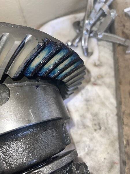

Well a month ago I brought my 8 3/4 center section to a very reputable shop to swap the gears from 3.91’s to 3.23’s. Supplied them with ALL the parts needed, and just picked it up today because they hadn’t even started on it. Covid world.
So tomorrow I’m going to attempt it myself. 489 housing with a crush sleeve eliminator kit from Dr. Diff so if anyone has any advice I’m all ears!
Well assuming I didn’t mess anything up the job was fairly straight forward, and only cost me about $40 in tools(bearing puller and rotational torque wrench).

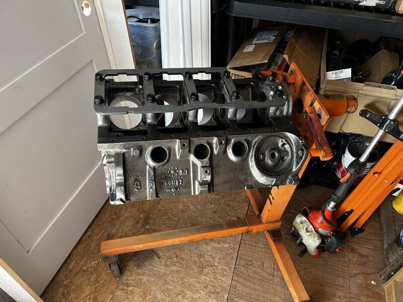

Decided it’s time to stop screwing around so my new build is at the machine shop now.
1998 magnum block with a half fill
Hughes main girdle and stud kit
Scat forged 3.58 crank
Eagle H beam rods
DSS -18 cc forged pistons .030 over
Custom hyd roller: 227/231 on 114. 603/560
CNC Speedmaster heads w/ valve job

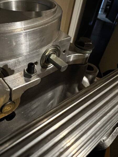

This throttle body is from Speedmaster via eBay, but it’s different from the other eBay pieces like yours. Part number pce138.1001 . Is your tps the blade type? The throttle sensor shaft on mine is a half moon shape, and Speedmaster sells their own sensor for $100 after shipping. I cannot find any info on an OEM sensor that works with it, but I’m going to the auto parts store hoping someone patient can give me a hand. I really don’t want to be stuck looking for an outdated proprietary sensor 10 years down the road. As for IAC I’m not utilizing that at this time. I’m using the micro squirt IAC PWM output to control my fan which is a bit more important at the moment.
That should use the standard GM style TPS. Commonly found on pretty much any LS based engine.
Thanks. The LS tps does seem to fit the shaft okay, but very loosely. It won’t work with the tapped throttle body holes, and throws the pigtail straight up into the hat, but I’m going to try it. Hopefully it will be accurate and save me $80

Maddart used one from a Nissan or Q45 TPS, on his now my throttle body, might see if it can work for yours.

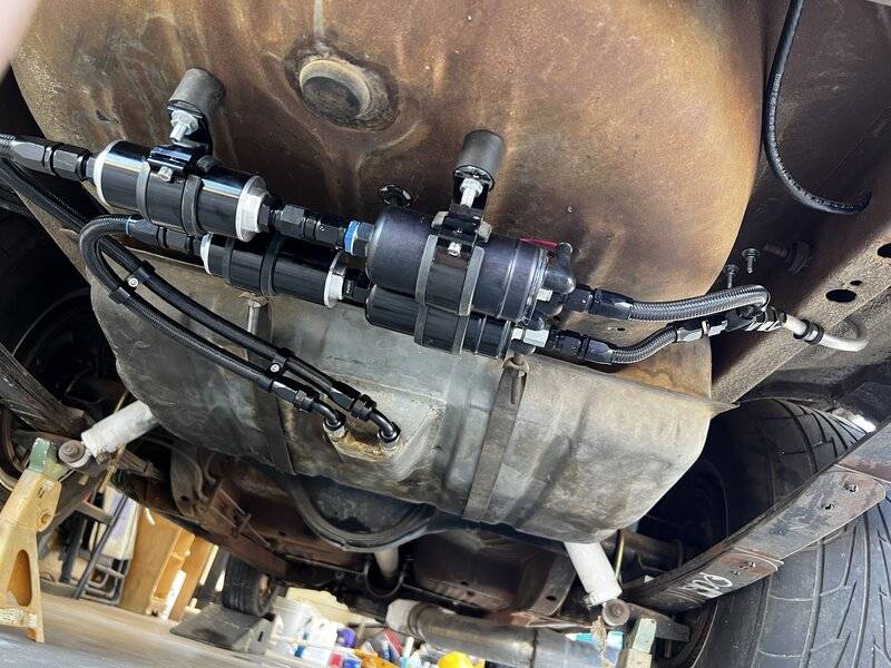

Manifold, injector wiring, and fuel lines are finished. Installed a second fuel pump, and waiting on a fuse block to finish wiring them. Then I can test for leaks and injector function. Once that’s complete I just need to bolt the manifold down and fire it up(I hope!). Oh, also need to figure out a throttle cable solution.
I did need to buy the $100 Speedmaster TPS sensor. The GM sensor just wasn’t going to cut it.
Engine is back from the machine shop. Forgot to have them install cam bearings so I’ll be doing that for the first time(using the rustyratrod’s write up). ARP head bolts are “supposed” to ship this week. If they don’t I’m going to cancel and buy the Speedmaster studs. Not my first choice, but the LS guys have had luck with them.
