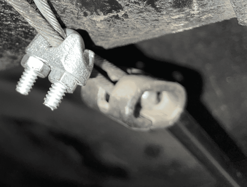

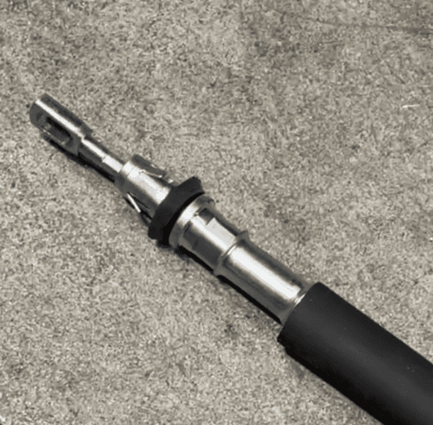

Retrofitting my parking brake cables to work with the 8.8. I know there are others who've just cut the stock brake cable shroud to get access to the cable wire itself and then built loops to grab the actuator on the back of the brake housing. I ended up taking a different approach. Grabbed a set of 2005 grand cherokee brake cables that I picked up for $26. Theyre about 18" longer than stock so I cut them down. The axle ends fit the housings nicely clipping into the factory ford 8.8 parking brake loop and the cables have a rectangular slot that fits the actuator with a little persuasion.
On the other side where I cut the housing I was able to route that through the factory hole under the car where the stock ones mount with the clip. From here you basically have to make a choice of how you want to connect both the stock exposed cabling system and the exposed portion of the new cable. I wasn't aware of any other method of building my own "Ball" at the end of my freshly cut cable that might fit into the factory cable to cable link. I dont know the term for it either if there is one lol.
For right now I have this clamp placed over both cables, but still looking for a better more permanent solution before I start adjusting the cable tensions. If I end up staying with this, i'll add a few more just for extra strength and to tidy it up.

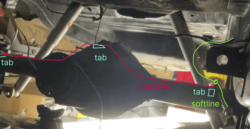

Also grabbed a good set of new hardware to get my rear shocks mounted to the new shock plates and bought some weld tabs for mounting the soft brake lines to the housing in a manner that will allow me to bolt them on in correct position. After that's sorted, the rear is done til the engine / trans go in.

I used a thing called a "nicopress sleeve" for that wire end application. Learned about them in some past general aviation experience. Bought the special pliers and used them a whopping once! Lol
You should rent those out and recoup your costs lol. I'm sure it's a massive market!

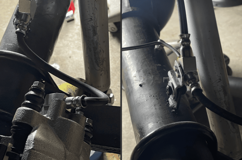

Got the tabs welded on and the hoses mounted now. The soft line bends are a bit sharp which was annoying because they had to be in order to point in the right direction. Also, my hardline tube ended up being too long so had to cut, clean, flare one side and now all the funky ford bends make it look ridiculous lol. It's hard to take the extra time to make things look great when customizing.
Last up for the rear is hooking up the brake line to the front to rear hard line at the stock location. Then fill, bleed, and test.

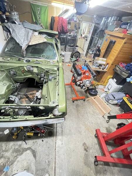

Just got my torque converter bolts and new 20:1 gearbox. Once the gearbox is back on i'll yank the engine off the mount and start mating it to the 727 for install. Exciting times!

just a note: when you get the car back on the ground, check that brake hose and make sure that it's not rubbing on shock body when the suspension is active.

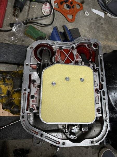

All right today I got a few updates. Put a new filter on the 727 and new gasket on the pan.

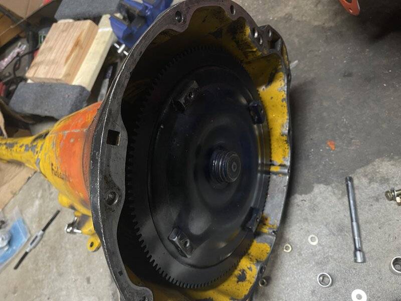

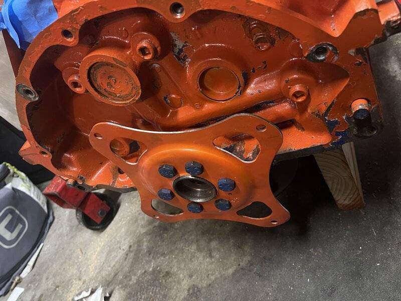

Following the instructions I mounted my flex plate to the motor as shown here but when I go to look at the torque converter there’s quite a gap. Is this normal? I assume if I start tightening the bolts down it’s gonna pull the torque converter toward the engine. Maybe that’s OK and that’s probably the way it’s supposed to be? I don’t know.
Bolted it up. It's ready to go in. Got the shift mechanisms installed. Starter installed. kickdown Lokar installed on the trans side.

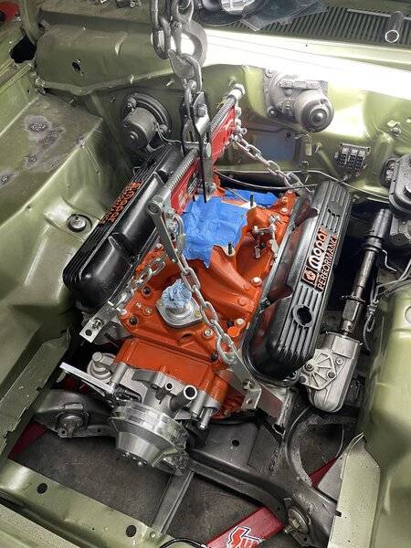

Any last minute checks I should be thinking of before the trans and engine go in? I always get paranoid i'll forget something that is 10X easier to do on the motor/trans while it's out of the car lol
anything in the engine bay that needs detailing/adjustment or attention: brake lines, electrical, steering box or suspension.
beyond that, let 'er rip!
I would prime the engine.
Definitely! got my oil prime shaft ready to go, but i'll do that once it's time to fire it up. Counterclockwise to pump correct?
