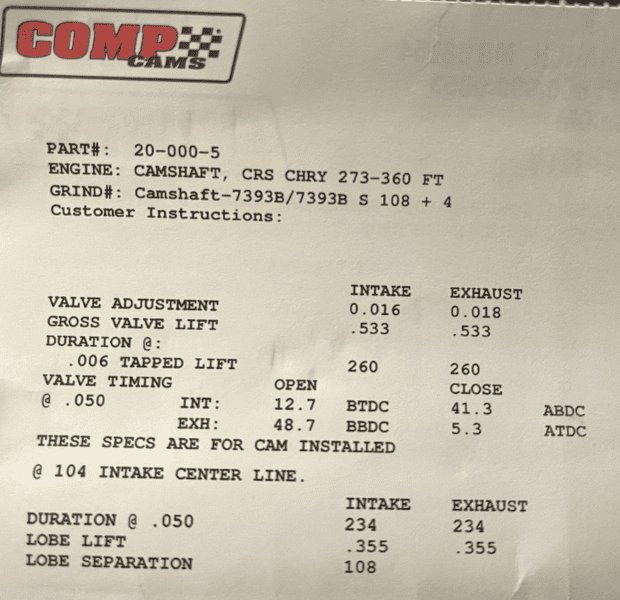

Got the cam today.

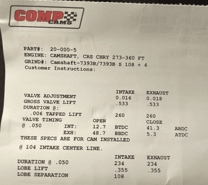

IMM Engine's custom grind cam specs. Brian mentioned with the speedmasters, kb107 slugs, air gap intake, and this cam I'm probably in the 430-440 horsepower range naturally aspirated. Sounds good to me. With the 3:73's out back should be a pretty stout street car.

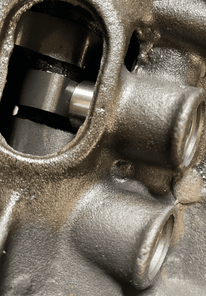

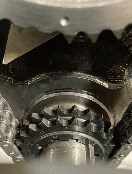

I've watched a few videos on cam degree process but im still a bit lost on my cam card and what im supposed to achieve.

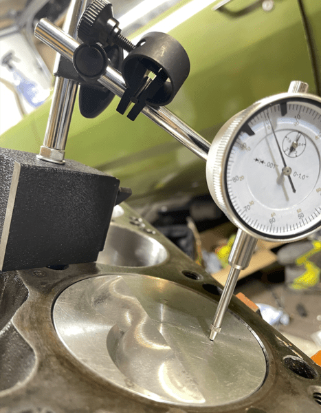

Using my balancer as a wheel to turn my crankshaft for degree process I have set timing chain dot to dot and piston 1 is at TDC. (went past 0 on the dial indicator 50 clockwise and counter-clockwise to zero out the exact TDC.
When I dropped in two lifters into the intake and exhaust for cylinder 1 they're not even close to even and you can see the intake lobe is rotating on its way up toward max lift. So at this point I just have a few questions:
1) Cam specs say 104 degrees intake centerline - does this mean using my degree wheel I should be rotating from TDC 104 degrees to push that intake lobe to reach it's max lift (center line?)
2) Lobe separation is 108 degrees, does this mean from intake lobe center line to exhaust lobe centerline is 108 degrees?
3) Does this mean Im supposed to advance or retard the crank sprocket to reach intake lobe centerline at TDC?
Thanks in advance, or retard...

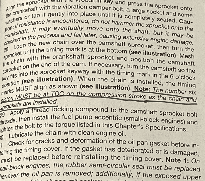

But number 6 TDC means.. number 1 cylinder is also TDC.
But not on the compression stroke. Cam is 180 (or 360 crank degrees) out from the compression stroke for #1.
The dot to dot method is easiest, but it doesn't put #1 at compression. Roll the motor over once and the cam will be at compression on #1 and the dots will both be at the top.
Makes sense. Very interesting these guys explaining this stuff online don't mention compression stroke but it's very clearly there in the FSM. Thanks Dion!

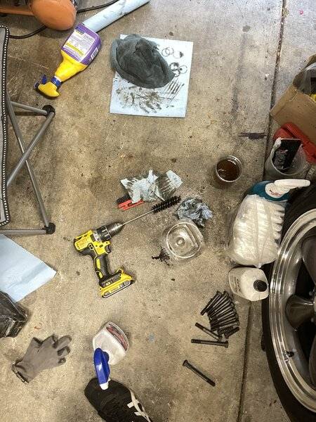

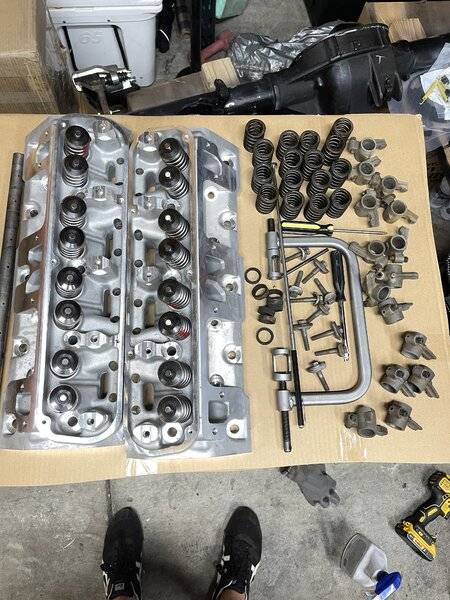

Lots of cleaning done tonight. Got the stock springs grime free and ready for cam break-in. Installing them on the heads next. Also cleaned up the 273 adjustable rockers. I also ruined my spacers by soaking them in white vinegar. :BangHead::BangHead: So need to find some replacements.
The shafts still need to be cleaned on the inside. Anyone know what cap replacements can be used for the ends? I wanna make sure the oil can flow well on these
Got all the stock springs swapped on the heads.
Stuck trying to figure out whether my 273 adjustable rocker arm shafts are worth using or if I need to buy new ones

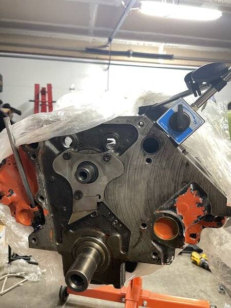

  • Verified the harmonic balancer TDC groove is accurate to TDC at center of #1 rod rotation dwell

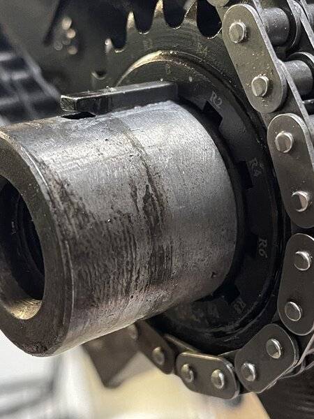

When do you all find resistance with the damper on the woodruff key? Mine seems to be immediately. Before I mount my timing cover I wanted to check

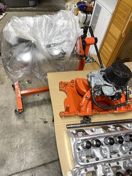

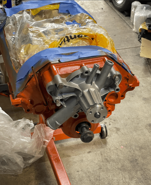

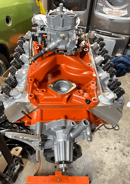

  • Timing cover installed
  • Water pump installed
  • Alt bracket installed
  • Damper installed
  • Just mocking up the rest to see where issues might be.
  • Head bolts are hand tight so I get measurements on the rockers when those are ready
looks like an engine again

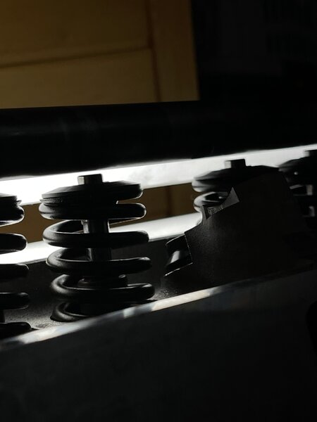

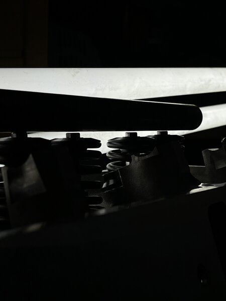

Well got stuck on valvetrain again.
I have some used banana groove shafts coming from Rocket. Meanwhile i was going to install my factory cast rockers to do the breakin since i have the pushrods… but then I noticed the valve stem height is pretty different between intake and exhaust valves. I messaged Brian at IMM engines about it so waiting to hear back.
