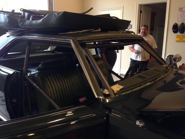

I was going to ask about which one was you in this picture. :)
attachment.php
attachment.php
I'm taking the photos! Lol...... Pete is facing the camera. The other guy is Dan.
Pete is building Dan a 2010 camaro. It was a theft recovery he picked up for 2k. Full back half and it's going to sit on the ground. Pete has the back half mostly done and is working on the K Frame right now and tying in the rest of the cage. The camaro is getting a TT small block. 1500 hp or so.
