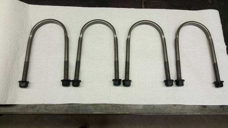

8.8 swap

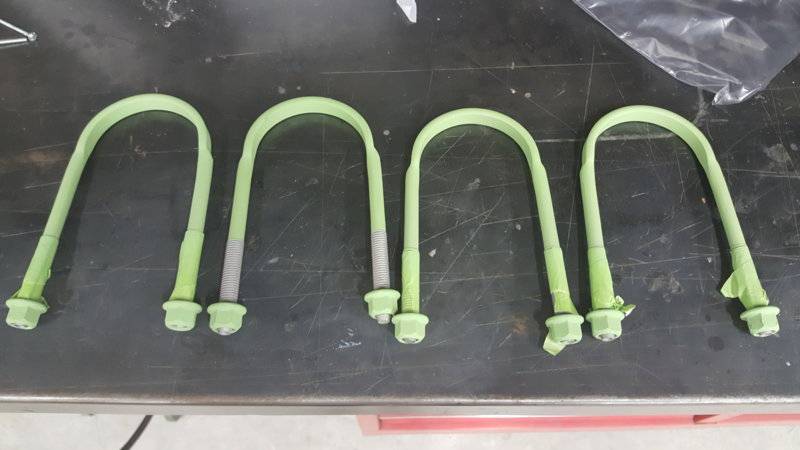

8.8 U bolts and nuts sandblasted, and shot with leftover epoxy etch primer that was headed for the waste drum. These are actually in great shape. Will be spraying them with cast coat grey paint.

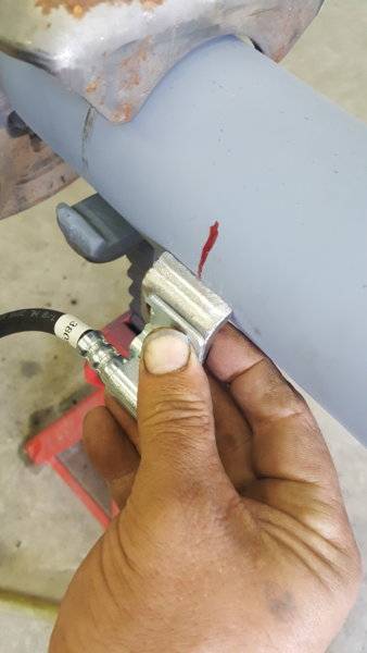

I also cut the old brake hose tabs off the spring perches seeing if i can use these over, i measured roughly 7" in from the brake backing plate. That was rough center for the exploder perches. Was thinking it would be best to keep the flexible caliper line mounting close to stock location. I tried seeing if i could locate the mount tab against the axle tube. I plan on doing this with both sides of the axle and using 2 RH brake hoses. Bottom 2 pix are the left side with a RH hose.

Stock 8.8 vent hole can be used as well. Its 1 inch off from stock mopar axle location as measured from the axle pumpkin center out. Mopar one is roughly 11" this is roughly 12" however it uses the same 7/16-20 threaded hole as the mopar axle combination vent/tee block bolt uses making this a direct bolt on. The combination tee block-flex hose i am using is 1972-1976 A body, however i dont see why the earlier brass tee with seperate threaded in hose wouldent work either.

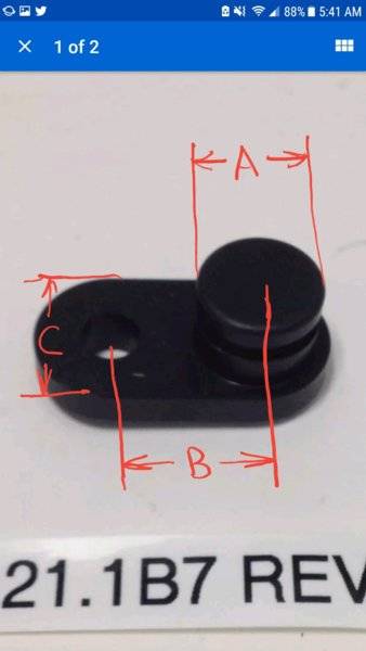

May have found a blanking plug to eliminate the VSS sensor thats filling a hole in the carrier. I asked the seller for dimensions off of it and will pull and check mine to see if this will work. If not i may tap the housing with a pipe tap and put a plug in there.

Here is what the seller gave me for dimensions on the blanking plug. Does annybody have this sensor out and can put a ruler to it to verify?
Dimension A =15mm
Dimension B = approximate 20mm
Dimension C =18mm
