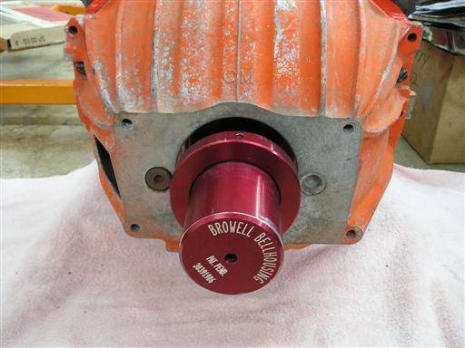

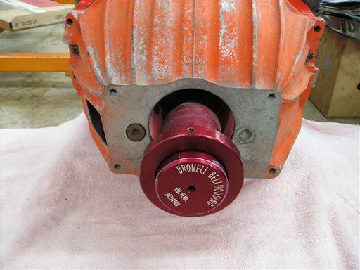

I take getting that measurement so seriously that investing in the Browell "jig" was well worth the peace of mind, and it also makes it easier for a visually oriented guy like me. I used it on my Roadrunner and will every time I put a bellhousing on, and I also bought the appropriate Pontiac version, for the TKO 600 that's in a box, to be installed soon behind a well built 421 Tripower.
These pix show the step by step process for using the Browell tool:

As to the bell housing centering jig, mandrel, fixture, I can't see it being accurate to much more than about 0.002" (0.001" offset) as it has to be a slip fit. But there's no denying it'd be faster than using a dial indicator.
Right. If you have a scatter shield (everyone should) and you order the tool for the big hole it won’t work on an OE small hole bell housing.
