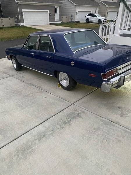

1973 Dart 4 door. With Ralleyes and with 5th Ave wheels and Super Stock springs
Here is a Dart I had quite a few years ago. 318 factory AC. Had about 40k miles. Put cop car wheels, dog dish, dual exhaust. It was a nice cruiser. They cost as much to work on as a 2 door. But don’t except to get the best return on your investment.

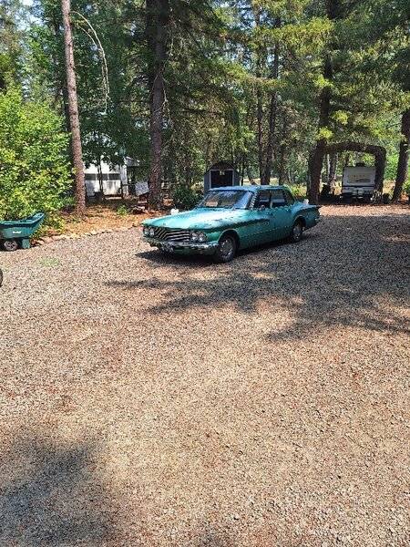

Here's some pics of my '61 Lancer 4 dr. 770.
Got it a couple of weeks ago. Runs great and has good bones.
Winter project, but I'm starting now.
Love this old bomb!

Love the color, inside similar? Send an interior pic. Mine had Oregon plates, last registered in '94 and similar patina.
Today I installed new kick panels in interior front. Some one had installed an underdash Panasonic stereo and speakers in the kick panals. Tore it all out and threw into the trash. This car was radio delete and plan on keeping it that way.
My plan is to get her mechanical sound and use her as a cool driver.
The engine runs strong and has a rebuilt (maybe) automatic that shifts fine. purchased new Monroe shocks but my trusted mechanic said the o0nes in it looked new and seemed fine. So I returned them.
Here's some projects for the future-
Need to hunt up another rear bumper.
Front windshield is starting to delaminate.
Speedometer is dead. This looks like a very long job.
I have detected no rust thru, just simple surface on the exterior that I have been treating.
Oregun winters are nothing to write home about, but this car will keep me busy with stuff I love to do.
The car came with a couple of boxes of parts. some are OK, but far from pristine. A couple a tail lights, grill, directional and a bunch of small doodads.
The Lancer's name is Virgil.

I came across a good deal on four wheels.
OK tires and 4 nice spinner hubcaps off a '65 dodge Coronet.
They are 15" with correct 4.5" 5 lug wheels.
Do you guys see any problem with mounting them on my "61 Lancer?
Thank you,
Steve

The 61 Lancer has a 4'' bolt pattern with 7/16 studs.
All will have to be changed over for those to work. It can be done with time searching for parts and some money.
You are correct.
Thank you.
I ordered 4 adaptors- 5 lug 4" to to 5 lug 4.5"
The tires are 195/65 radials.
I plan on installing when the adaptors arrive.,
Can think of any other problems I might encounter ?
Thank you, so much for the heads-up!

Yeah, there is many things to consider.
I'll try 'em out when the adapters comes in.
