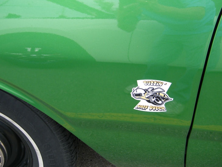

lifted mine off this site and got the pinstipe decal guy at work to make them. I put them on the fenders to be different and they look great.. I'm saying thank you too.
I think the buzzin Bee is friggin awesome !!! Looks good on the fender !!!:cheers:
