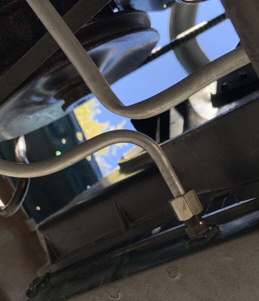

I’m trying to think about this, and it doesn’t make sense that a hot transmission would be related to an engine running hot. But I found that one of my transmission cooler lines is kinked. I don’t think the flow is completely obstructed, but it’s definitely being choked.
Obviously I’ll replace it, but I’m just curious as to whether this would affect engine temp at all, or just the transmission?
That kink shouldn't might affect the cooling of the transmission, but not the engine. It probably won't have that much affect on the transmission unless you are running a high stall converter with a lot of HP.

I think the flow through the cooler lubes the trans, I would sure fix that kink
I agree, I'm ordering a replacement set soon. Unless there's a way to fix it? I've never had great luck fixing kink in tubing like that.

That kink is not folded enough to affect transmission fluid flow very much, if any.

- this comes from a guy who sees a kink in a hardline that appears to be close to 50%, inside of a bend, and calls it “not folded enough”. Dude that tube is trash! That tube could barely drain a/c condensation
