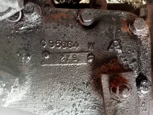

Hi all
I found this gearbox for sale
The seller says that it's a 4-speed out of a Barracuda. With this offset lever, I don't think about an E-body, but rather an A-body.
Can you ID it?
:thankyou:
well, it's a 66~68 inland non-console shifter and it's a standard output trans (non B&T) so that lines up. it's got a /6 bell, but that doesn't mean much.
it's 4spd and it's a-body but without the numbers the specifics are impossible to know.
Don't forget Barracudas were A bodies until 1970.
Yes, I know :) . It's why I think it's out of an A-body, because (if I'm right) E-bodies never got an offset lever.
The seller just said "Barracuda gearbox"...
It's A body, no question because of where the shifter mount is. Looks like a good score.
Had a shifter like that in my 68 Barracuda 340 Formula S in the console.

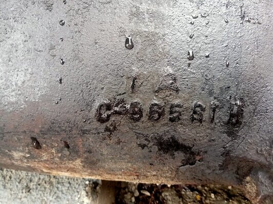

You are better getting the casting numbers off the tail housing and bell housing. Check out the numbers on the Brewers Performance site. I'm thinking 66 or 67 Dart, Valiant or Barracuda.
E bodies and I think 70 / later B/C/ etc are instantly recognizeable because the tail has TWO shifter mount positions. E body used the rear mount, the only vehicle I think, to do so.
The other side of the trans will have or not have a flat machined pad with numbers on it. If it is a 66-67 it will not have that pad, if 68 it will, Those numbers shown don't mean much...
It's an A833?
Yes, it's an 833 four speed. It is quite possible that it is a 66-67 transmission that uses a slip yoke that is the same as a 904 automatic. 68 and up 833's used the same slip yoke as a 727 automatic. If it's for sale at a good price, you should get it. Hurst shifters will bolt right on and work fine.

It's an A833?
Affirmative, and that's definitely the small output shaft. Most likely came out of '66-'67 'cuda, if You were on this side of the pond You'd have a market for the bellhousing &/or whole unit. As above, if it's a good price snag it. I have the same trans, My particular one has the 2.66 1st gear, I pounded on it behind My cammed 'teener in My '69 Dart for a couple of years, then for 3 years behind the 383 I dropped in the '83 Diplomat with nitrous. Killed 3 clutches & blew a u-joint, and I slick-shifted it synchro-less & clutchless shifting. I wouldn't put it behind a 440 or Hemi with large slicks, but it will take some abuse, just make sure to use solid HD U-joints w/o holes drilled in them for greasing.
