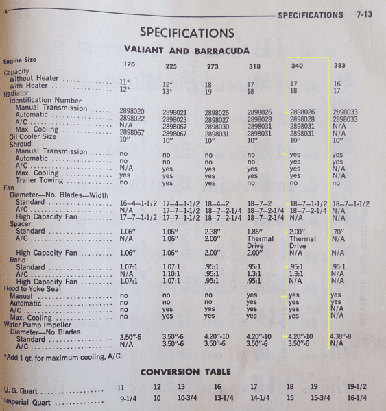

Lets look at the original expected coolant temps.
1966 Dodge Dart Coronet FSM
1970 Plymouth FSM
Notice with the earlier cars, 175 degrees is the minimum where the radiator is allowed to begin to aid in cooling. Further that full flow to the radiator is not expected until the temperature gets up to 200 degrees.
With the later cars using 190 and 195 degree thermostats full flow doesn't take place until 210 and 215 F.
Another point of reference can be had from smogged vehicles equiped with coolant temperature overide switches. For example the HD CTO used by AMC Jeep to head off overheating at idling with A/C running on a hot day kicks in when the coolant hits 220 F.

A/C water pumps were driven faster than non-a/c water pumps.
35% faster in 1968
The faster they are spun, the more liquid flows and the likelyhood for cavitation increases. Those are both minimized with the smaller impeller.
Ignore the yellow markup. That was for someone else's question.
