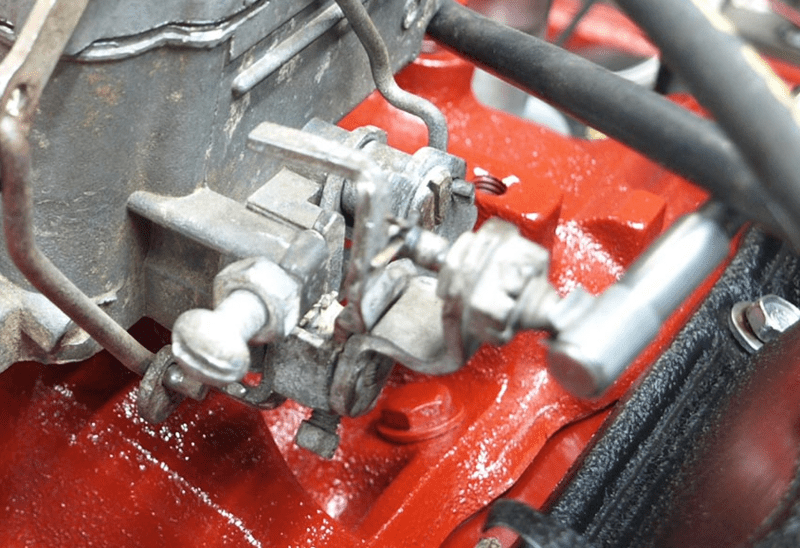

With all this cobbled carb/spacer business, it would be interesting to see the throttle linkage/kick down, if its an auto.
Besides the direct bolt on, set and forget advantage of an Edelbrock, the factory linkage is bolt on as well.

ah no i didnt. just snapped the pics so id make sure to put it back how it wasHave any zoomed out of the complete linkage ?

If you're going to use that Holley, here's the throttle linkage adapter you need as well...

Looking at my pic vs this one, not sure how my trans kick down would work with it??

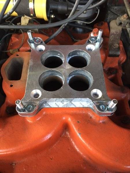

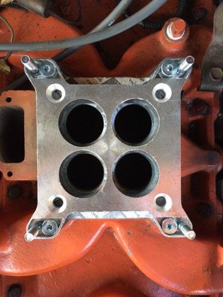

Carb plate arrived.
Looks pretty good - as you can see above the top ports are a bit wider than the exit ports (for lack of better verbiage). I lined the top gasket up with a stock gasket for the manifold:

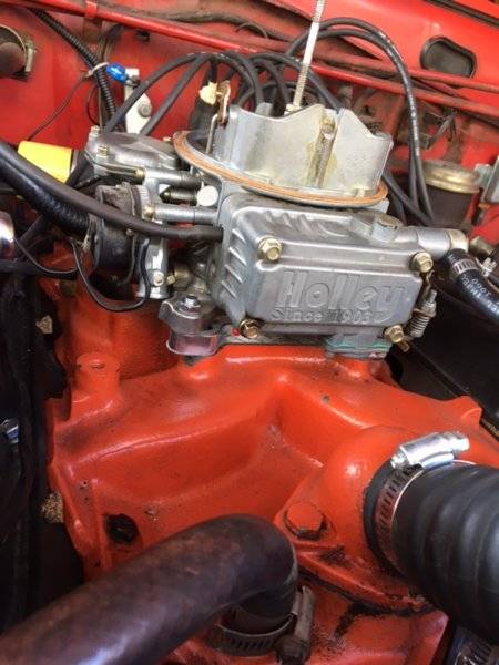

After a quick test fit on the Holley it bolts up well. I'll do the install tomorrow morning and see what happens..
