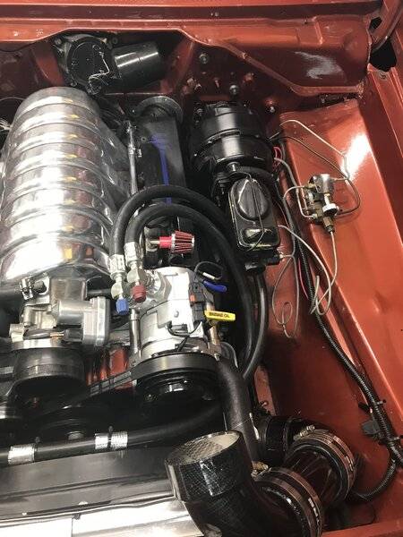

Just an update. I have everything done under the dash. I put my radio in the glove box. Had no where else to put it. Moved My ECM. JUST WAITING ON FITTINGS for my compressor. I had to order some low profile 90 degree otherwise my hood won’t close. I have a 5.7 truck motor so the compressor sits up top. We finally had a cold front blow in this weekend so I figured I’d get busy. Only 99 degrees. My electric bill is gonna be high. I pump AC from my house into the garage.
This is what I had to do to close my hood.
This is what I had to do to close my hood.View attachment 1715573286
That’s what I figured I’ll have to do. I already have the accessories moved out- not far enough apparently. I may have to do like you and swap the alt. And compressor around. I did not want to do that since I already spent the money on the billet brackets I have now. Hopefully the fittings I got will work. I have the 6.1 intake on mine. Same issue you have. Thanks for the picture.

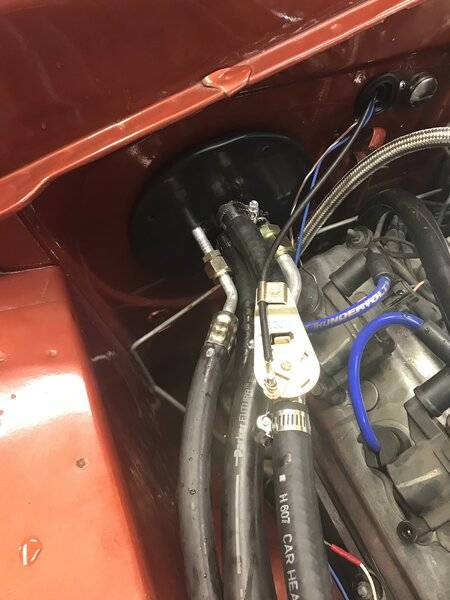

On this setup the hoses do matter how they are hook up. If backwards like I had it at around 2500rpms the AC blows hot air because the valve is forced open when the return is hooked up the feed side. At least they had in the tech support section.
I do have too say this is pretty nice having AC and Heat. I used AC yesterday at 97degrees outside and today the heat at 56. The heater cooked me.
