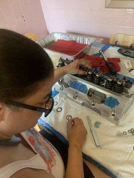

LOL, yes I know and I purchased a set from you with the rocker arms. Below is the wife setting up “Her TF heads” (on her kitchen table) that I call and purchased with her money.
(We had a issue with TT getting attaching hard wear for a couple of weeks.)

Wow, she is building on her kitchen table?! Wow! Now that's a great woman!!! woo hoo!!!
Thanks and yea man! When the time came to upgrade her ride, she asked what’s the best head currently available. I told her the TF’s are brand new, have great flow rates, showing there excellent reputation yet again showing love on the MoPar guys, IMO, it’s what to get now. So she said order them up and get me 1.6 rockers with it and handed me the cash. Her money, not mine.
