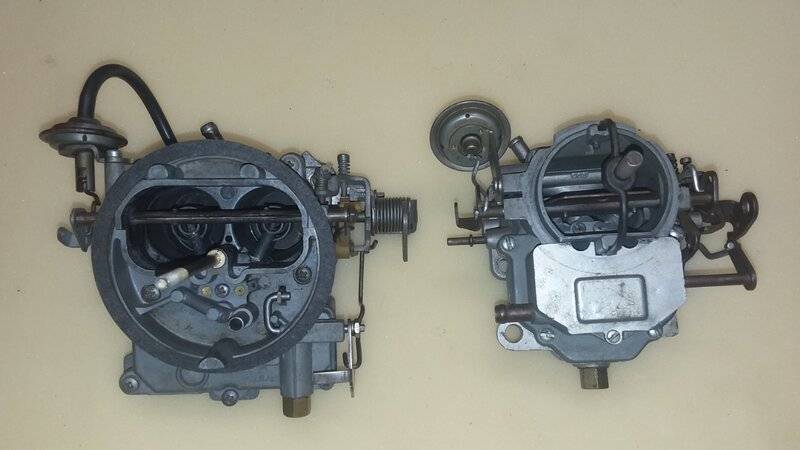

We have already talked about (post 419) which mopar 2 barrel intake manifold they might be running.
What about which stock 2 barrel carb (with mods) they will choose to run.
I would choose to run the mopar carb on the left to make the power.
The mopar 318 stock 2 bbl carb on the right is an economy carb and it's going to take some mods to bring it up to task.

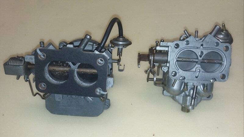

Big difference between these 2 carbs right here.
Let's see what they come up with to give the 302 headed 318 enough fuel to rise to the occasion.
That Holley 2210 on the left was updated with a 2245 model. There is a plug above the PV which, if removed, allows the spring tension to be adjusted. They rate at ~[email protected]"Hg delta, the throttle bores are 1.55" & venturis are 1.385", I was running this on the "Killer6".
Using a 360 2bbl intake would make it a bolt-on.

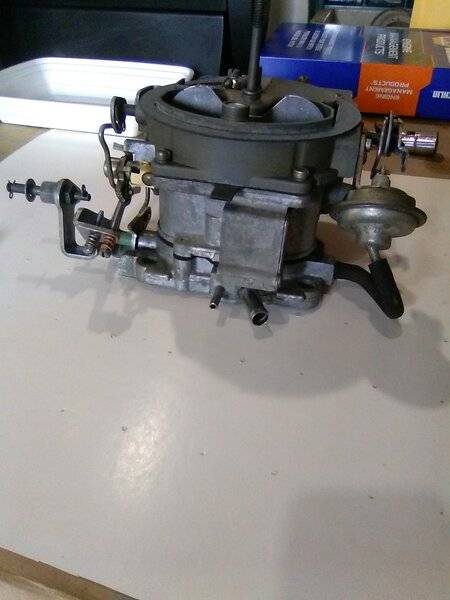

The Holley 2245 has a 2-ring booster. This large-bore BBD has 1.562" throttle bores, & 1.314" venturis, with a single/traditional booster. And a metering rod/jet arrangement.
Diff pic of same carb I posted in the "other" MI thread, just rebuilt for My Buddy's survivor '71 Satellite Sebring-plus 383.
Which engines did the large bore bbd come on? Between the two carbs which do you think would have the potential to make the most power?
