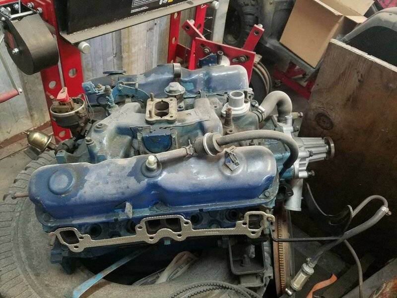

Back a year or so before I got my first driver's license my dad had a 76 charger SE ((a Cordoba with a different grill and taillights) that had a real tired 360 in it. He went and got a low mile (supposed around 40k Mile) '77 318 out of a lebaron, in a local junkyard, that was originally a lean burn 318. No way we were adding lean burn to a car that never had it....
We took the original Holley 2 bbl intake and carb, and the distributor out of the original engine and ran it on the "new" (to the car anyway) engine.
My brother parted out an extremely rusty 74 charger around then. The 727 came out of there, went in for a "bench rebuild" and went in behind that 318. I wasn't yet old enough to drive even though I did about 75% of the wrenching on that swap. My dad couldn't believe it, that Car ran better with the 318 with the 360 intake carb and ignition than the 360 those parts came from, ever ran in that car.... And was way better on gas too.

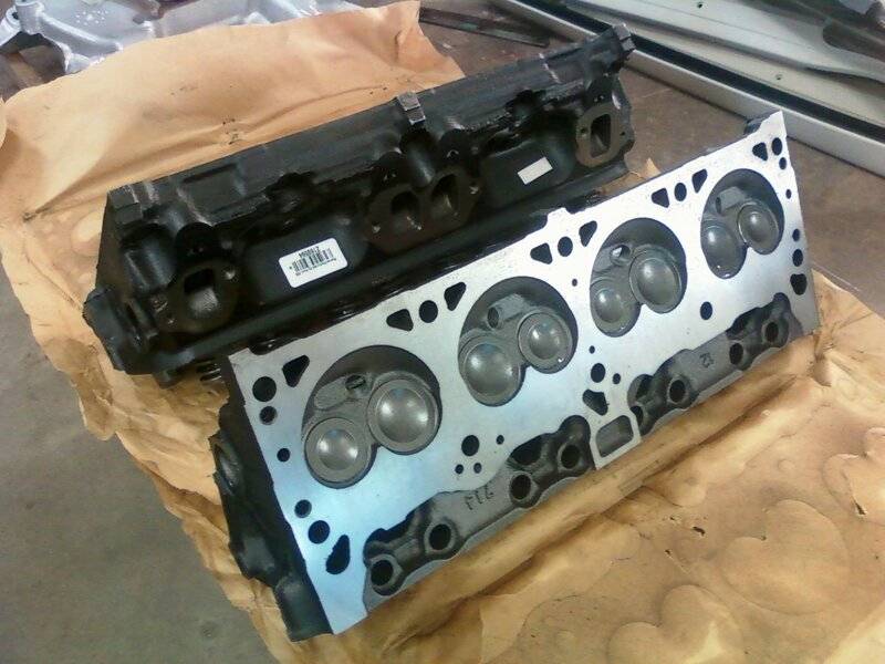

More flow testing on ported 302 heads.
Flowing at 240 cfm.
More flow tests to come on next upcoming videos.
One with the Dual plane attached to the 302 heads, and one with the single plane attached to the 302 heads.
Stay tuned. more to come with the 302 head porting results.
Stock pictured 302 heads.

Wait......he said they flowed 244 cfm @ 500 lift with 149 cc intake port volume and DV said he did a set of E7's about that size that made over 500 HP. WOW.
Magnum head, same size port and 1 c hair the work will bury that. Better chamber, better exhaust ports.
