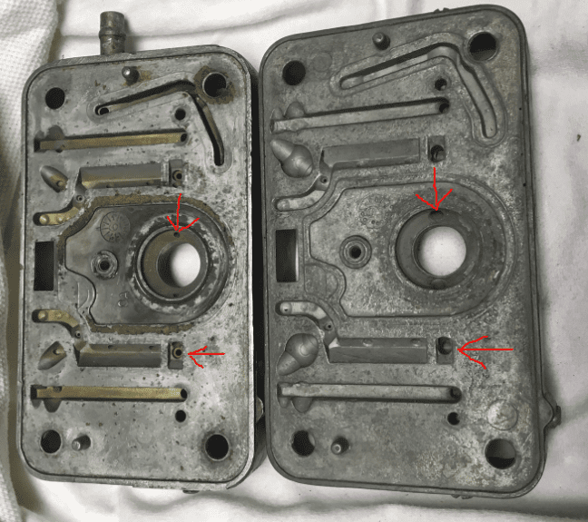

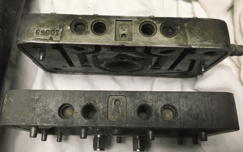

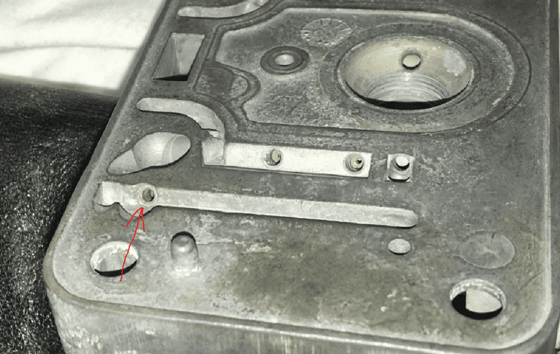

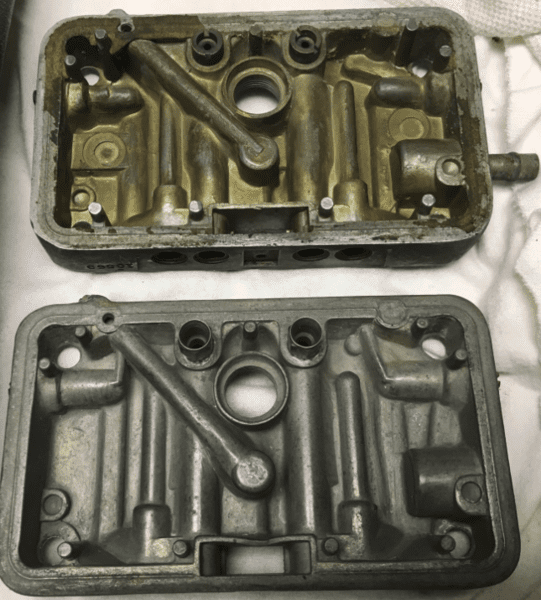

On the left looks like to be an unmolested primary block.
It has port for timing vacuum, low position IFRs, power valve.
On the right, not sure what it was originally.
Angle channel looks like it was enlarged (alcohol use ?)
No provision for ported vacuum, and never was.
Power valve but restriction holes are very large - again possibly alky.
IFR might be in the cross channel at the top (white arrow).
It also might be pressed in the idle upwell, under the cap.
so the larger PVCR is not an issue if it becomes the back metering block. It will have a Power Valve Plug in it anyways.

If it's a secondary metering block it's not an issue. If you want to use it as a primary...then it's an issue. You should probably drill both plates out for threaded channel restricters.
I know next year I'm going to go back to true 1:1 throttle linkage and run a power valve in both ends. I think when you run enough RPM and gear it's a better way to do it.
so i still have the problem of the brass restrictor in the bottom on one and in the top on the other. how is this going to affect the install?
^^^ Agree. The one you got off the carb looks fine, but the other looks like its been worked over for alcohol. It might work as the secondary block with the power valve blocked, but if it were me I'd look for another unmodified block.
Pick up another 3310 off ebay, screw them back together with the blocks you pulled off and sell them.
