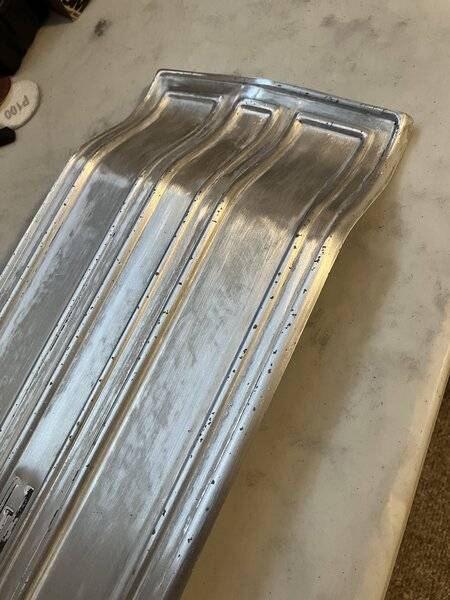

I have spent a few hours sanding after the anodizing was removed. My question is do I keep using the 100 grit paper until the pit marks are out or do I sand a bit with 100, then sand a bit with 220, then sand a bit with 400 etc, etc. until the marks are out?
That is anodized aluminum. If they aren't too deep you can strip the anodizing and sand them out. Finish by polishing the raw aluminum or send it off to be re coated.
Should I just sand with 100 grit until the pot marks are out? or should I sand with 100, then 200, then 400 etc, until the marks are out?
i'd sand with 100 'til the marks are almost gone, then the progressively finer grades will fully remove any traces left.

I sanded mine starting 100 and worked my way up to 1000. Then buffed to a good gloss. I used a Makita electric palm sander which leaves oscillating sanding marks which polish out easier than straight sanding marks.

Not that I am dedicated to buying everything from Harbor Freight, I use the buffing compounds they have and drill mounted buffing wheel. Hope works for you.

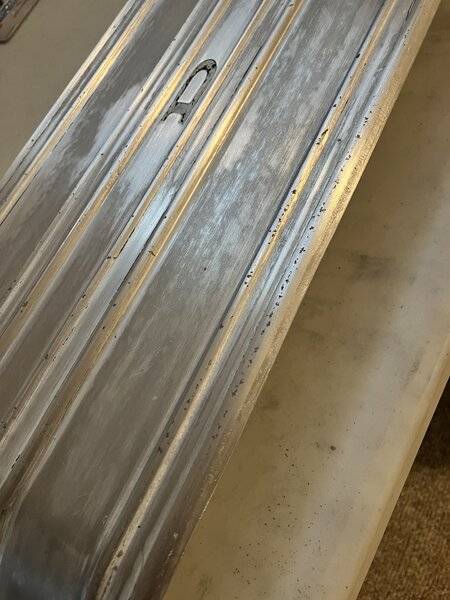

Question for you……. I have spent several hours sanding with 120 grit paper. I have made progress with regards to the pit marks but they are still there. Do I continue with the 120 until they are almost gone or gone entirely before I go to 300, 400, 600, 800 etc?

No, powdercoating your tailpanel will not cure your problem.
You will get back a tailpanel painted over with the pits showing as recessed areas.
The only cure to your problem is to get another panel without pits.
No matter what RustyRatRod tells you (and the multitudes of other over propagandized Members on here), powdercoating is paint and looks like paint, not polish aluminum. You will not be happy.
Do a post asking members about the big mistake they made powdercoating their Grilles.
And once it's powdercoated, you can't remove the crap, unless you grind it off.
Suggest you clean the TailPanel up as much as poss and sell it CHEEP to somebody with a street car who can overlook the pits.

Thank you for chiming in, much appreciated. I’m just going to fine sand it, polish it up and paint it. If it doesn’t look too bad I might install it if not it goes up on my wall and chalk it up to experience
