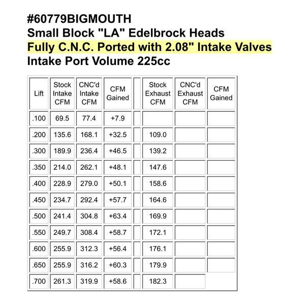

Trying to make a decision on which heads to use.
It seems that performance wise based on the online chart numbers I found, both heads if fully CNC ported they are pretty much capable of the same flow @ .700" lift?
Indy 360-1
Edelbrocks RPM
What is the advantage of main differences between both?

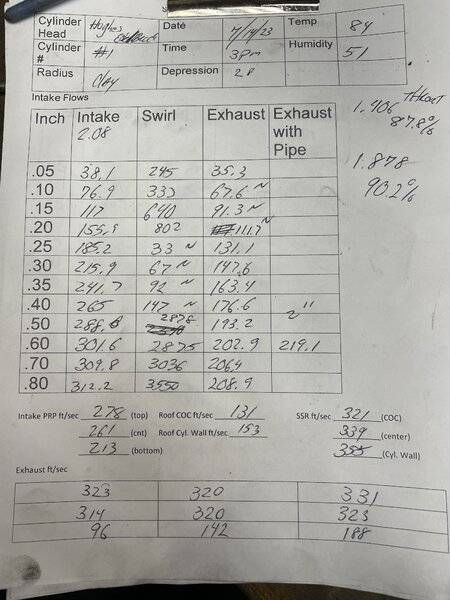

I just took my Big Mouth heads out of the closest to bring to Charlie Servedio’s SF-600 bench. He will have the video up later. I don’t know exactly when. He is doing a set of Magnum heads right now while I have a smoke break. Then a video for that head.
Check back at his channel for the video when he posts it up for more information and a little flowing around.
https://m.youtube.com/@servediocylinderheads
We spent the morning flow testing 600-AFB mods. We just got done with the heads.
Now I don’t like to race flow bench numbers due to various conditions and factors that can’t be controlled. It’s easy to say, if he calibrated his bench why didn’t match my bench and why is guy #3 have even a different set of numbers? I’ve had my W5’s flow tested 3 different times on the same bench model in 3 different locations by the 3 different people flowing them telling me what the flow plate size is with that being the only different factor. A 4.185 plate, a 4.03 plate and a 4.06.
What’s the point? A cylinder head will flow differently on different bore sizes. The larger the bore size, the more air the head flows. The computer should make corrections but just how flexible the program is I don’t know.
What it did show is the flow curves which all had a certain amount of spread between them about equal to their bore size. This is what you really need to know. How big the the flow plate is and what the curve looks like. The cfm amount goes up with the bigger bore and if the test was on a 4.185, how does that compare to your 4.03?
Head dependent, it can be a little, it can be a lot. On top of that, if the operator thinks his bench is doing the right thing and it’s not, let’s say 3% stingy and the other bench is 3% happy, that’s a lot between them.
The following is the flow test of the Hughes Big Mouth head.
Take it for what it’s worth and compare other benches at your own peril. This is what we got today.

Rob, what was the bore size for that test?
Also, not sure the OP knows this, but the BM heads require offset intake rockers.
Rumble is this the way they came from Hughes with any other modifications { valve job, port grinding etc. } ?
Box stock! I fit in a set of Lunati solid roller springs, outside springs only. When you see the video, what you is what you get from them.
Overall, not bad. Not great ether. I’d stick’em under a 414 (or greater) & the best intake you can get, which, IMO would be something like a good tunnel ram, not the old Edelbrock unit or an Indy intake or a well done super Victor. At the minimum, a well prepared Victor.
I’ll try several intakes for my own enjoyment. Some call it dumb, weird, but! Because I do weird stuff, you’ll know. Pittsburgracer ported a single plane M1 for me with nice results. I have a 1,000 TQ. Not a combo you ever see. So, that’s why I’ll try it. Good, bad, indifferent, home run? Failure? IDK, nor do I care. I just like trying stuff out. It was the only way to learn pre internet and I had a ton of doing it I just gotta get back into screwing around again. Best way to learn, get greasy baby!!!!
Hey PRH, at the moment, I don’t remember. I’ll post it up when I speak with Charlie next. I know I posted this before… wait… I think I did. Fudge! Now I’m not sure, I’ll check with Charlie.
