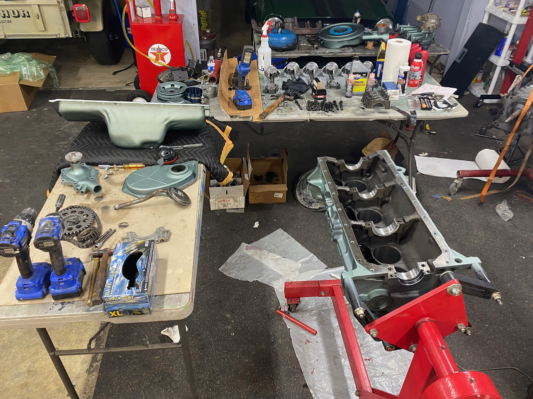

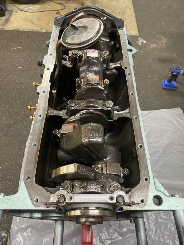

I was so meticulous when putting my engine together, spic n span clean, used anaroebic sealer, RTV, etc., I put mine all together, weeks later, and there it was, a leak in the rear main area. It's difficult to figure out if it's the pan, rear main seal bracket, or rear main seal. Even with the engine on my engine run stand and good light~ just difficult to pinpoint the LEAK, or more like a steady drip in my case. So, one has to address everything all over again. I feel just because a mechanic is experienced, they're human and can mess up as well as any of us.
So, now, I had to work on the engine with dropping the pan, at least on my engine run stand. I despise this design. So, drop the pan, clean up, have new parts on hand, new tube of RTV this time, be careful not to push the rubber gasket(the one on the pan to the rear main seal bracket), I had it all together, then felt around and I had to loosen all the pan bolts, fanigle the rubber gasket back in place! omg. I've ran it for at least an hour overall, and so far ok. (knock on wood!)

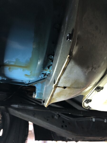

Hi Guys/Gals: Cruiser here. I've been enjoying driving my slant six 1974 Duster with its newly rebuilt engine. The motor runs very well, but I just cannot get rid of a persistent rear main oil leak. The shop that rebuilt the engine is very experienced and reputable. They installed a new rear main seal in November of 2024, which failed a month later. On Dec. 12th, they installed a new seal which is now leaking after about 1500 miles. So I'm looking at putting in my third rear main seal in about three months. So what's going on here? Does anyone out there own a slant six that DOESN'T leak oil out of the rear main? Does such an animal even exist? I could really use your advice, especially Slant Six Dan if you're out there. If you did cure your leaky seal, what product did you use and how did you install it. Is there some kind of super duper seal that I need to use this time? My expectation is for the engine to go 100,000 miles without leaking. Your thoughts? What worked for you? Am I nuts to expect the floor under my Duster to be clean and dry?
