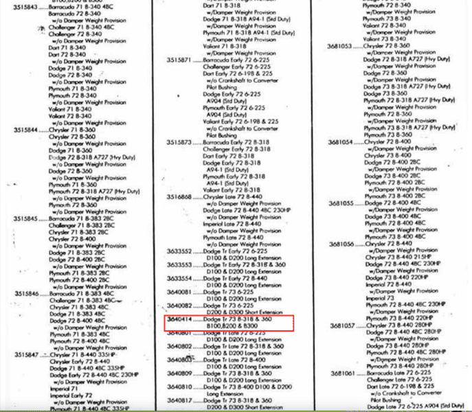

Dodge truck 73 8-318 & 360 B100, B200 & B300

PK3640414 4340 0525

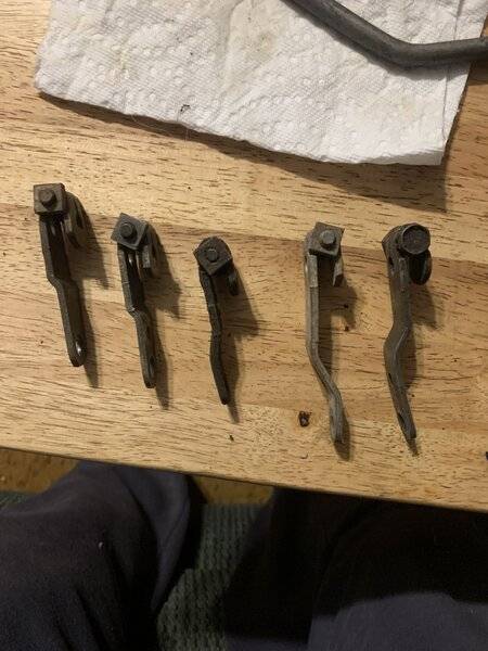

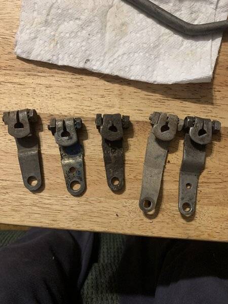

I see part of your problem-the kickdown lever that you have on the trans is for the 1 pc rod system. That is longer than the one you need. So in reality the ratio is off by quite a bit. The short levers are for the 3 pc bellcrank system and the long levers, like yours is for the 1 pc rod system. You have to have a short lever! And put the rear hook on your pretty purple return spring in the U on the end of your throttle cable.
Do you have a photo of the two different levers? Im sure swapped out that lever when I mated the trans to the block and connected the linkage initially when it was on the engine cart because I couldn’t make it work but I will take another look to verify.
I'll get out tomorrow and find a couple and try to get a picture posted unless someone beats me to it.
