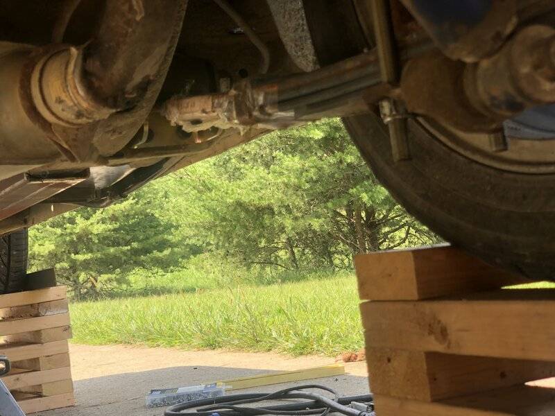

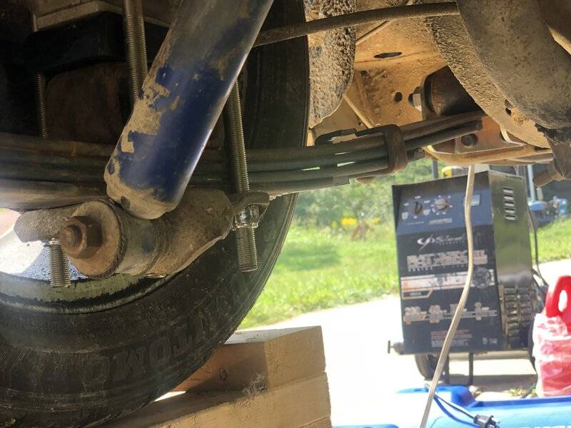

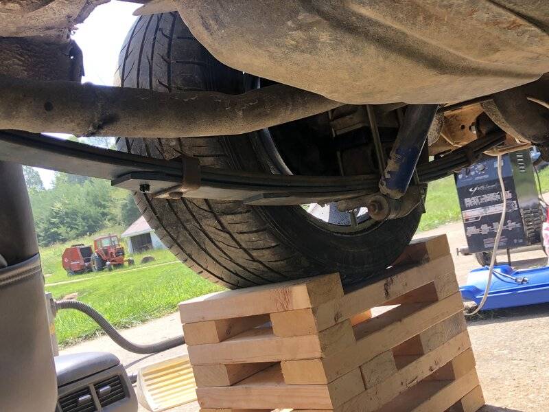

So the rear springs worked out? The front segment is straight?
I found pictures of my MP springs in the car and out and they were deformed even after they were back out of the car. I'd forgotten how bad they were.
Yeah they look good as far as not being deformed. The only gripe I have of them currently is the fact that they currently aren’t anywhere close to a “zero arch” spring like they’re supposed to be. I bought the front spring hangers with the two sets of holes, installed the springs in the top hole and still had to run 3” drop blocks to get the car down where I wanted it. If the springs level out in the next few months, I’ll just pull some blocks out.
My old springs had settled to zero arch but they just didn’t have a high enough spring rate. My brother, his wife, my wife and I went on a 2hr roadtrip last Christmas and the bumps were BRUTAL with two people in the back.
Yours do look better than mine did in the picture you posted awhile ago.
Here's how mine looked in the car:
Here is a picture of mine after I pulled them out and next to the original 6 leaf springs I put back in the car:
Don't remember for sure, but pretty sure they didn't look that flat before I put them in.
Sounds like they maybe fixed the springs? Other than maybe going too far with the arch.
Wow. Yeah those deformed bad! I’ll snap a pic of how mine look when I get home this evening.
Here’s pictures of my springs.

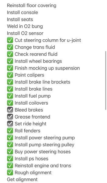

Well, this evening I checked a few more things off the checklist! My radiator hose coupler finally came in so I installed my lower radiator hose and heater hoses, painted my coolant bottle bracket and got that bolted in and the hose hooked up, welded in the last of the seat brackets and welded a reinforcement plate to the bottom of another one of the seat bolt holes, welded some spots on the subframe connectors that I’d missed (probably when I ran out of wire a while back), painted the subframe connectors, transmission mount and bottom sides of the patch panels I put in, bolted the drivers seat in, filled the radiator with water (I’ll put coolant in after MoParty, in case it happens to puke on the track), dropped the car down off the wheel cribs, cleaned a bunch of tools out of it and then DROVE IT FOR THE FIRST TIME SINCE JANUARY!!!
It needs an alignment (pulls to the right) and the front brakes don’t feel like they’re grabbing like they should be so need to bleed those some more BUT the car rides and drives like a whole different car!! But I guess that should be expected, suspension wise it IS a whole new car! The steering is responsive, zero slop and the turning radius seems to be much tighter! Our road has some decent dips/bumps and it took them MUCH better than the 1.03 bars, worn out 5 leaf springs and Monroe shocks. It also just dawned on me that I don’t think I set the adjustment on the QA1 shocks at all. I’ll check that tomorrow.
I think the suspension got settled in a little bit on the drive. The drivers front is at 23 3/8”, passenger front is 23 1/4” rear is right at 25”.
I’m hoping to get the grille in tomorrow, and finally get y’all some good pictures of the car!

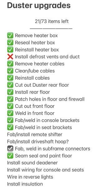

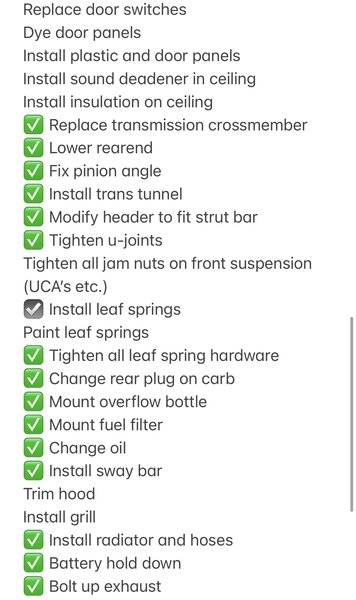

For the “list makers” out there who are curious, this is what my list has morphed into for this year down/round of upgrades. (I’m not naturally a list maker, but I knew I needed one on this set of upgrades)
The black check marks mean that the task is completed enough for the car to function but not done do the finished result that I want it to be.
“grease frontend” for example, I plan on driving the car some, then regressing the frontend to make sure everything is properly greased.
It also just dawned on me that the front pads and rotors are brand new… guess I shouldn’t judge the braking quality just yet, until those are properly broken in.

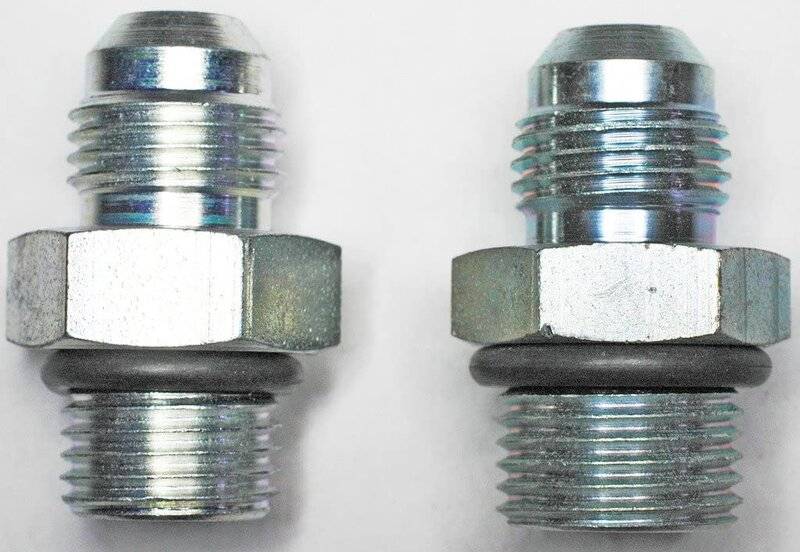

I kept getting power steering pump whine today and every time I checked it it was low. Got it up on jack stands tonight and had Marge turn the wheels and discovered that I did EXACTLY what I’d read not to do… over tightened the o-ring to AN fittings that go in the rack :BangHead: the fittings I got from speedway have these janky little Teflon washers on the which, if over tightened, push out and cause a leak!! :BangHead::BangHead::BangHead:
So tomorrow morning, I’m going to go to the local Napa (they open at 6:30) and see if they have some actual o-rings that fit these fittings, like this…
If they don’t have them, there’s a hydraulic shop literally just down the road from me so I’ll check there. They open at 7.

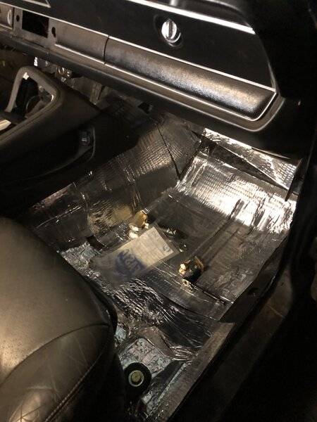

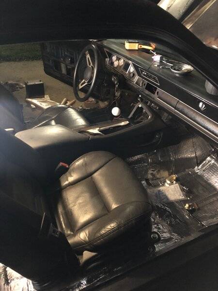

Worked on the Duster for several hours again this evening. I had put the center console in last night but it had more wiggle play to it than I liked, so I take it out and triangulated the rear brackets and that stiffened it right up. I also installed a bunch of sound deadener, installed the passenger seat, then wired (temporarily, but it’s wired) the seat belt solenoids in the seats, so they allow the seatbelt to function.
it’s SO nice having a center console with cup holders!
