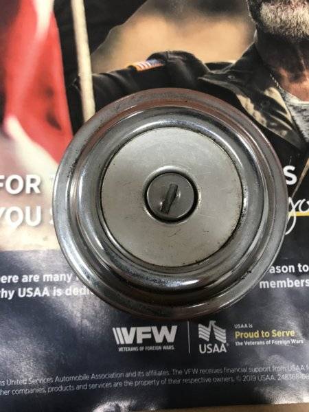

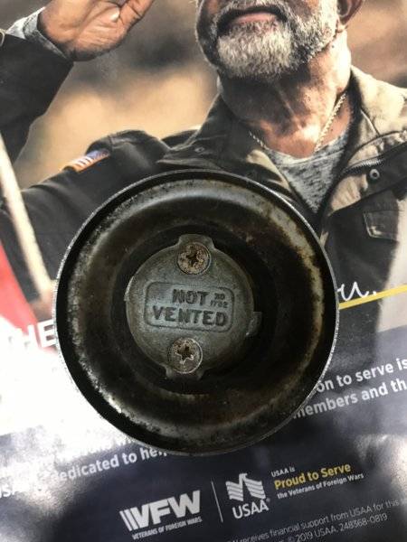

Went to the junk yard today, got a savable lockable fuel cap with one key. Hope it fits.

Thank you. I have tried the cap, and it can be put in. But, the rubber seal is so hard that I can not push it far enough in so the locking tabs goes in and locks it. I have to find a new seal. At least I need to see if this is what is the issue.
