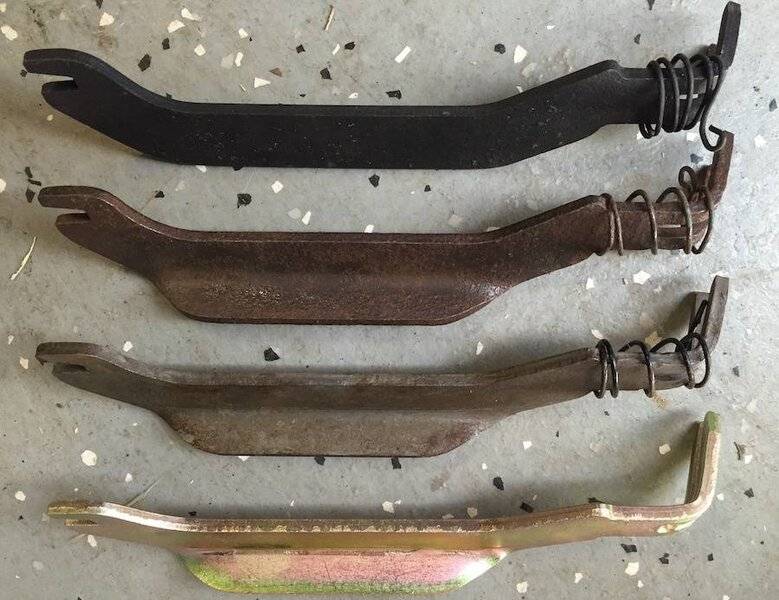

you have a cone type sure grip -- thrust button shown in the pic is correct for the cone type sure grip and looks to be ok -- looks like the pinion bearings gave up or the yoke nut backed off and the pinion was chewing on your carrier -- the pic you posted of the backing plate shows the turned up edge of the parking brake strut which i have only seen on stock A-body backing plates . B,C ,E body backing plates have a flat parking brake strut.

The pic you posted of the backing plate shows the turned up edge of the parking brake strut which i have only seen on stock A-body backing plates . B,C ,E body backing plates have a flat parking brake strut.
That’s actually not completely true abut the parking brake struts. The SBP A-body drums have them. And pretty much all of the 10” BBP brake struts are flat. BUT- 11” brake struts also had that bent section. Not all of them, but a whole lot of them.
These are 11” brake struts, both factory and aftermarket
