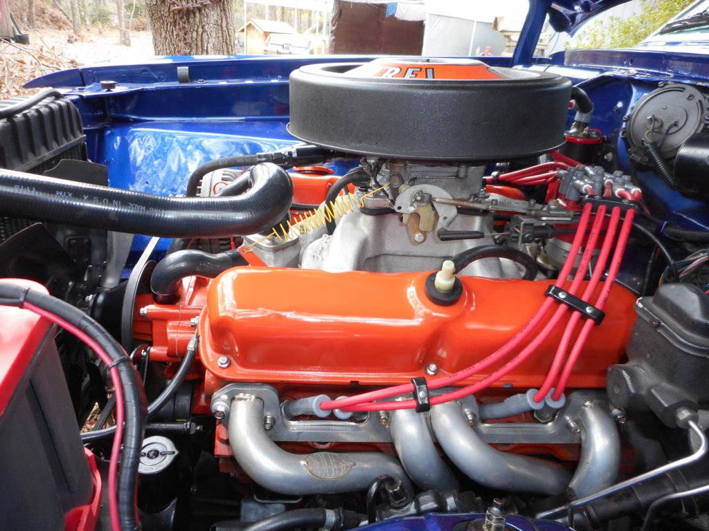

(but the pic of the carb is definitive, there is no kick down linkage connected)

That is some funky throttle bracket that you have on your intake..... no adjustment! Makes one wonder if you are even achieving wide open throttle.
