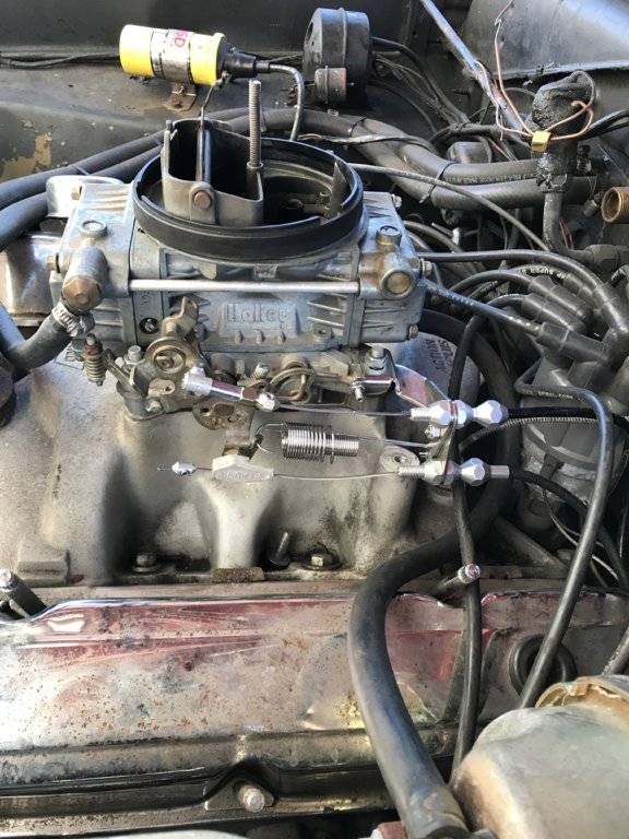

Ok, so I'm not sure where to go from here, apart from try a Lokar throttle cable. The original cable won't get down to a straight enough angle so I had to try putting springs in all kinds of funky positions, to give me some kind of return when I pressed the pedal down. So when the throttle finally acted normal enough for a test drive, I had nothing, wound up, could hear the pump in the trans winding, but she wouldn't shift. Throttle cable from Lokar is about another 50 bucks, probably the cheapest solution at this point but I'm concerned the trans is toast.
If your careful, you might be able to cut the sleeve of the stock throttle cable and that will give you the flexibility to use it instead of buying another one
As for the transmission, have you tried manually shifting it?
(It is probably toast, because it was ran without a kickdown but there may be a manual valve body in there aswell)
Ok, so just to clarify, if there's a manual valve body, the kickdown isn't necessary? I'm assuming that there were way more that were NOT manual valve bodies with the way everyone recommended right away that the cable was necessary. I didn't try the manual shifting but I will this weekend when I can spend some more time under there and maybe do some adjustment. Is there any way to identify what type of valve body it is without dropping the pan and having to refill it? I couldn't find any numbers stamped on it when I looked before but it was night time, so I'll check again (of course it could have been rebuilt but at least I might know what it was originally).
I ordered the throttle cable today, just because I want it to be correct up top and if that's what I need to do, so be it, I'll just set aside a few more ibuprofen for afterwards :mad:.
I didn't look super close at the cable at the end of the transmission, but I'm assuming it's set by default to have most of the adjustment up top. I talked to Lokar on the phone and they asked how much I cut off. I said huh? LOL. It actually is a hair to short at the carb, so I'm thinking I have to at the very least re-run it to make sure that there's enough slack on both ends. Now that I know how it attaches up top, I should be able to get it straight and if it doesn't work then, I'll know I'm now in the market for a transmission.
I shouldn't have mentioned the manual valve body, your first post makes it clear it is not, because it was shifting on its own back then, correct?
It does look like you trimmed the kickdown pretty tight, and left the adjustment on the wrong side, so to speak
You may need to trim the outer sheath to make it work
On the bright side, the throttle cable should be a breeze

Here's a suggestion for you.
Take some of the bend out of the bracket where the green line is so that the cable points right at your linkage attaching point, and then add a slight bend in the throttle pressure cable bracket to get it back in line.
Also, since the trans shifted before I suspect the TP cable is just adjusted too tight.
With zero throttle at the carb, the lever at the trans should be pretty much fully forward.

So I pushed the run closer to the middle of the firewall and now I’ve got a crap ton of room. See photo. Now I just have to figure how much needs to be adjusted up top.
I also cut the front part off of the stock throttle cable and am going to see if I can just use the ends of the Lokar cable and attach to the existing cable. If not I’ll have to crawl under the dash and deal with it. I’ve tried once and am too big to be under there without pulling the steering wheel which just adds more time to getting this done.

Ok so after much ado, I may have saved my transmission yet. Attached is a photo of the linkage and cables attached up at the carb with a decent amount of slack for further adjustment. I video recorded a trial run to upload so I’ll upload that a little later but essentially it’s shiftin now between 30 and 35 for 1 -> 2 and 45 and 50 for 2 -> 3. I don’t think that’s optimal but at this point I’m ecstatic that it’s shifting semi normally. It’s not kicking down so there’s work to be done for sure, but I’m at a better starting point than I was before.
Success! Good to hear!
Sounds good so far, but pretty high in the shift points.
I just used a light spring to insure the lever on the trans was pulled all the way forward with zero throttle.
Without a shift kit the trans should be in third by about 20mph.
I think with the shift points so high that is what is messing with your kickdown, and once the shifts are within a normal range it should come back.
You are almost there.:D
