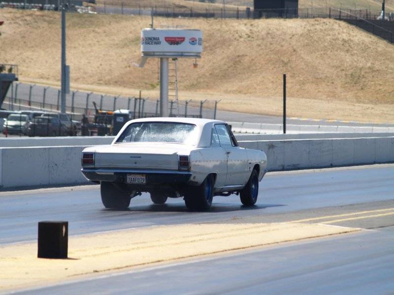

Here is a photo
Made it today! New best 10.96 @ 121.00 mph. I jetted the carb up 2 sizes all around and and pulled out 2 degrees of timing in third gear.
The DA was 3370, 82 degrees.
Car weight at 3170. MP 380HP 360 with Comp Hyd Roller .570/.555 243/257 @ .050., M1 SP, 750 Holley, IMM RHS iron heads, ATI 8" converter stalls at 4600.
4.56 Dana 60, 11.5/30/15 MT slicks. I footbrake, leaving at 2200.

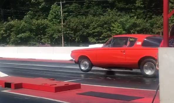

A couple guy messaged me for the engine combo and some specs on my Sons Duster
.030 over 360 with a 250.00 set of JE pistons from Ebay (open chamber style)
Stock 360 crank
Molnar rods
used 100.00 (610 lift roller) I found on Facebook. comp cams roller lifters
Edelbrock heads that I ported and updated to a 2.08 valve
Matched and ported 340 victor intake
750 alcohol APD carb
1 7/8 Hedmen headers
Car
1970 Duster 3200 pounds at the line
8 point cage
frames connected
Caltracs and mono leafs Rancho shocks, 90/10's in stock frontend
8 3/4 rearend, aftermaket axles, spool, 4.10 grears
727 transmission with 5600 stall converter.
Has gone 6.54 four times should go 10.20-10.30's in the 1/4 mile
