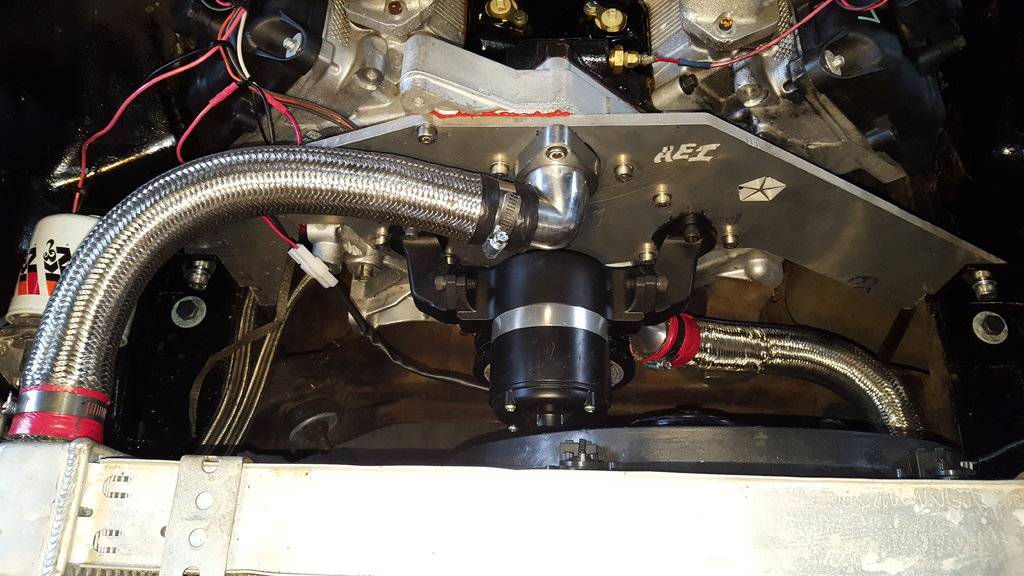

2nd time to the track with the Duster project car. The goal was to build a 10 second drag car.
Little River Texas, 90 degrees and humid, motor is popping a little, plugs showed lean to okay, time to change jets and maybe timing. Seems to hook okay, dies after burnouts:
Upgrades:
4.56 Dana 60
Motor plate/electric water pump
...and after a little tuning:
best 60'-1.39
best 1/8th- 6.34@108
best 1/4-10.08@135
Leaving off idle, shifting at 6500rpm.
