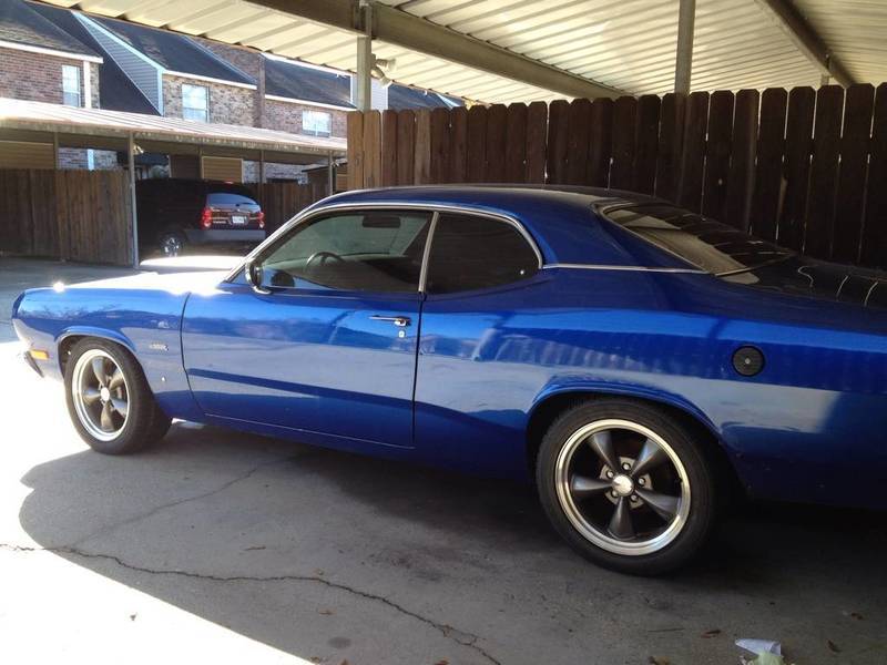

Post your wheel and tire combos.
Car year and model Many
Front
Wheel Brand - Showwheels
Size 17 X 7
Backspacing 4.25
tire size 215-50-17
Suspension mods none
Rear ------------- same as front
Wheel Brand
Size
Backspacing
tire size
Suspension mod

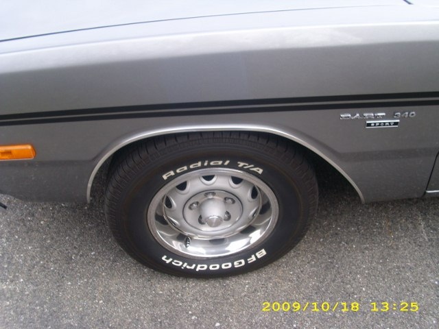

front 215/70R/15 7"wheel with 4 1/2 BS
Back 255/60/15 8" wheel with 4 1/2 BS
That's a nice look for that car. A touch of old school.
What wheels are they?
