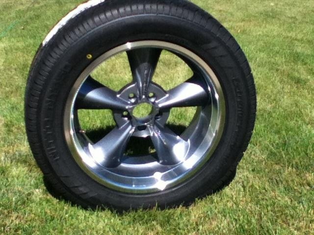

I finally was able to get the 68 on all four wheels today. The super stock springs really cause a lot of adjustment to be needed to level out the fronts end. The drivers side is cranked way up and the passenger side way down. Will also need to trim the lower front edge of the front wheel wells. The 225/50r17 rub in mild turn.
Fronts: 225/50r17 on showwheels Streeter 17x7 4.25" backspace.
Rears: 255/50r17 on Showwheels Streeter 17x8 4.5" backspace.
Mods are SS springs, SSBC front disc brake conversion.
Those look excellent!! What color are the rims?

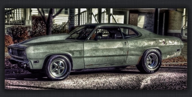

72 duster
fronts- 26-4.5-15 mickey Thompson sportsman pros
rears -29-15.5-15 mickey Thompson sportsman pros
wheels are Billet specialties street lites
fronts are 15-4.5
rears are 15-10 with 6.5 backspacing

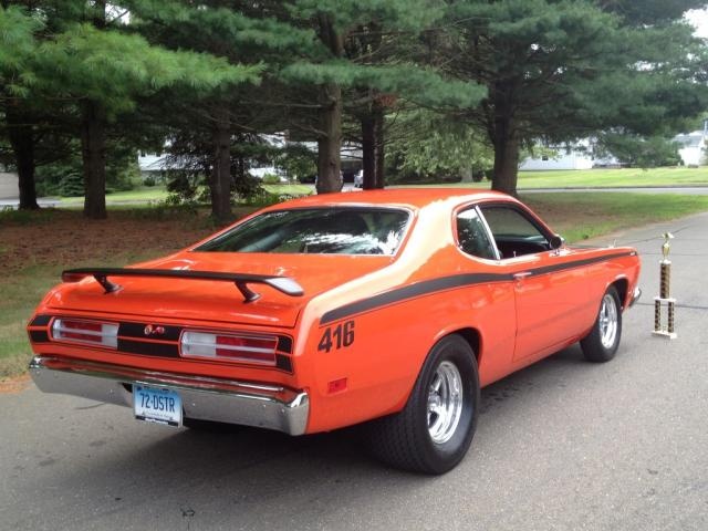

Fronts 15 x 4 with 2.125 bs running 175 65 15, rears 15 x 8 with 4"bs running 255 60 15.
American Racing Torque Trust D gray matte finish, running Wilwoods front & no other suspension mods.

72 duster
fronts are 15-4.5
Did you move the springs in and massage the wheeltubs at all?
love this green duster,,

They look great and so does the car as a whole 416. Nice work!
Wow 340Duster247... What a killer stance / look your car has!!! Great job!
