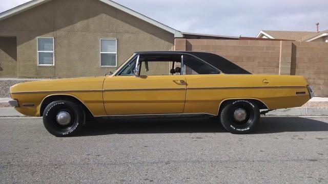

Front
BF Goodrich T/As 205 60 15
classic industries steel 15x7 wheels
4" back space
stock suspension
back
BF Goodrich T/As 245 60 15
classic industries steel 15x8 wheels
4" back space
stock suspension - rolled quarter lips
You say rolled quarter lips...does that mean they're just slightly too wide? I ask because I just bought the EXACT same wheel combo from Classic Industries and now looking for tires.
nice Dart BTW:thumrigh:
