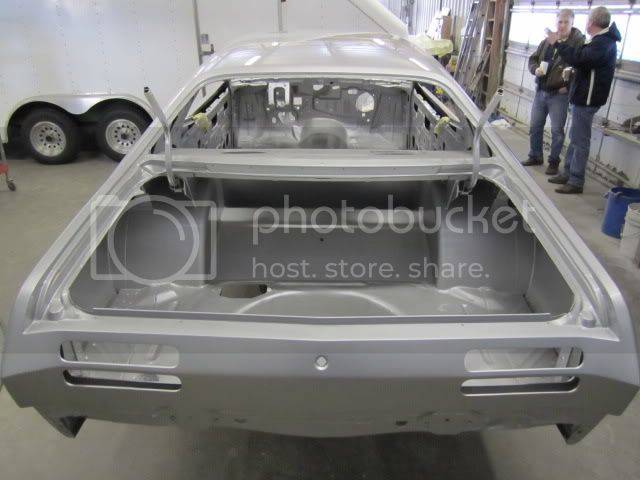

No. The car is back-halved with the frame rails over an inch a side narrower than the
stock rails. large wheel tubs and 4-link. Don't know the housing width but Denny would.

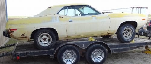

I've seen many back half jobs and I have seen maybe a handful that look as clean and as tight as this job. Kudos to the builder
