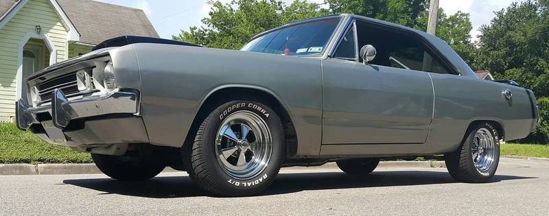

1971 dodge dart swinger
Small bolt pattern
14×6 205/70 front factory 340 wheels
15×7 245/60 wheels vintiques mopar steel. 4" backspacing on the rear

On the ground. PST 1.03 bars are ordered to get that front end down.

205/70 R14 all around
BFG redline

Finally got out for a ride. Needs an alignment now really bad lol
