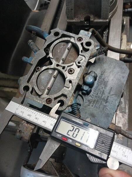

Believe it or not, Those won't fit. THey are between the BBD and Holley 500 bolt pattern. I have one too and it will not fit the intake, OR the adapter plate. Weird.

Yeah that's the one. That's a bastard one only bolt pattern. Same as mine. It's in between the BBD and Holley 500 pattern. Really weird.
Are you insinuating that slotting the holes in the base plate at an angle will not work? I was thinking of how the blp and qft base plates that fit both 4150 and 4500 are. You could humor me with some measurements off of that intake LOL
