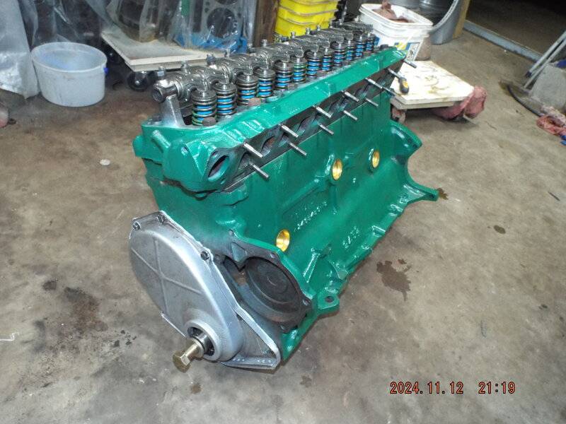

Project Cheap & Nasty is now a short block. New timing chain and new camshaft sprocket, but original used crank sprocket. Used stock cam and all. Used oil pump with big block high pressure sprAng. The rod bearings I had were for some kinda V8. There were 8 pairs and they were the wrong size, so the original rod bearings went back in. They weren't quite as bad as I thought, although one did have some pits.
So, Cheap & Nasty moves forward, however slowly. Got the manifold studs in the head, sealed with Permatex #2, so yall can argue about it. Got my rockers, shaft and hardware all cleaned up and sprayed down with Fluid Film. If you've not used Fluid Film yet, I highly recommend it.

Got the oil pump pickup screwed in, the oil pan painted from Hemi orange to green and my oil pan bolts soakin in purple stuff.

So far, all the money I have in this is two tubes of grey RTV.....sue me, I used RTV on the sides of the oil pan because I couldn't find the cork pieces and I also used it on the timing cover because the paper gasket I had was so rotten it broke into like four pieces when I picked it up. A new rear main seal and one can of garden green paint from Ace Hardware. I already had one can. I also splurged in a new oil pump pickup and big block high pressure oil pump sprAng. So far, that's all the money spent. Less than $50
