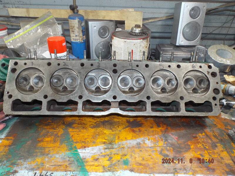

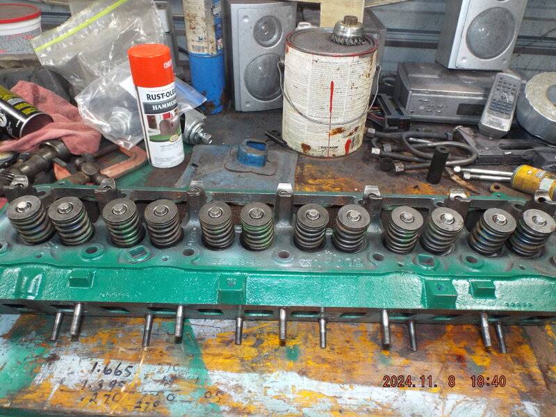

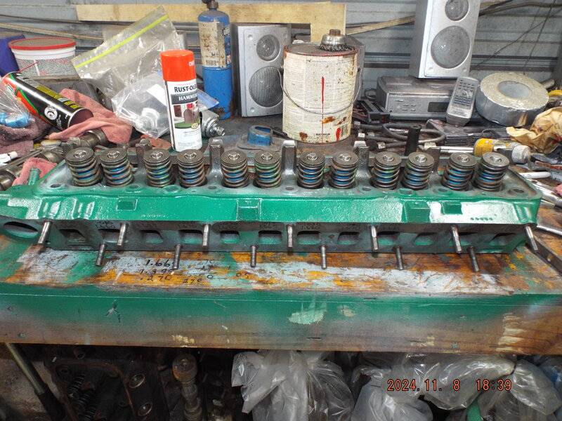

Cheap & Nasty now has a completed cylinder head. Turned out good.

Actually, there's none. They were striped green originally. They were in a box when I painted the head. lol
what kinda surgical suite you operating out of over there man? don'tcha know when ya paint a motor yer supposed to paint everything? stops the insides from rusting too!
besides, that's how the customer knows you rebuilt it!
