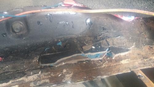

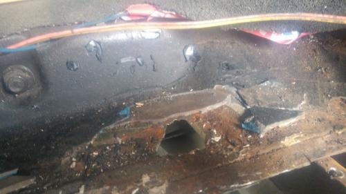

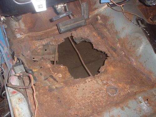

Here"s the latest pics , first 3 are a series of whats under the shyte ? while scraping some seam putty off where the front edge of the trunk floor is going to lap my screwdriver went through the floor near the passenger side inner wheel house making me think here we go with the next section of full floor replacement but it turns out there is good metal surrounding the hole so a patch will be doable , gotta love how they did a layer of Kitty hair then some sort of blue membrane then another layer of kitty hair .

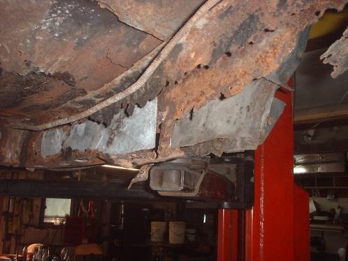

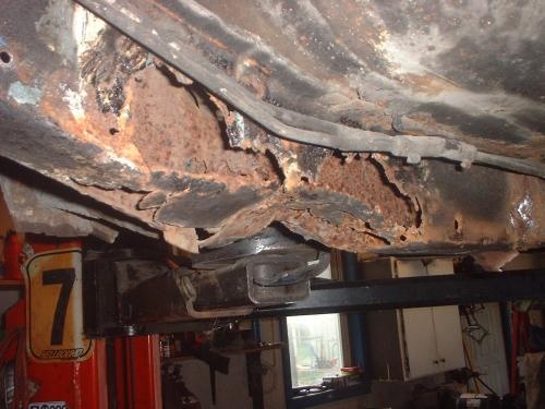

Cracked back saves the day . If you look close in the second pic you can read the parts numbers on the frame rail pieces try finding used steel pieces that clean here in Canada eh ! A liitle hammering on the flanges and some cutting to size and these babies will be welded in .

That section of the rear up and over pan always rots if you have a leaky window. I may have a section of that as well. I had to replace mine on the Orange Bomb, and killed a couple of those panels in the process.
Thanks man but the panel is solid and so is the floor around the hole , in fact if you look real close you can see the original green paint peeking out from under the shyte on both sides of the hole and it continues around the end of the hole and up to the panel I think you are talking about, I believe AMD calls it the "Shock Mount Panel"either way it's all good except for that hole and of course the free formed kitty hair parts of the inner wheel house's that will be on the next round of rework after I get this back third solid and new again .

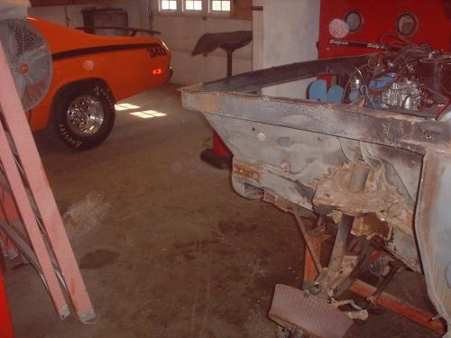

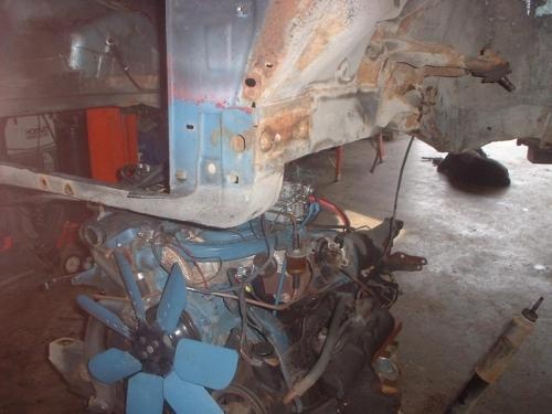

Now he wants the quarters from the Demon shell that Steve is removing put on his car. I'll flatten them out with the loader first
