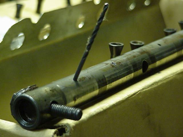

Okay now you guys made me get up off my bed leave my coffee go out to the garage get an old busted rocker shaft and pull out a flat file and use the edge of it. And it was kind of like I thought. Because of the roundness of the shaft using a straight edge it would get deeper in the center naturally. I think using something round would make it even deeper in the center? Also it's before 7 in the morning here on the West Coast and I'm not firing up my grinder with my wife still sleeping LOL to see what the round wheel would do...
With hole in center of groove, it will be the deepest part, especially if groove is cut with round disc.
Dimensions on factory grooves would be interesting to see.

Now I think this would be easily solved if a member had a set with the grooves and laid straight edge in a factory Groove and see if it's flat or if it's concave?
That file job actually looks pretty close; the grooves do taper. That may explain why they were angled.... Simplified machining.
Also that picture is available because jab sent me a replacement shaft for that broken one so I could file on it like that..
If you're making your rocker arm shafts for the adjustable rocker arms don't forget to put the second hole in the shaft. You can see it in that picture that is posted showing the slots.
According to Yellow Rose those holes from the factory are in the wrong spot so this is a perfect time to line them up where you want them to be and then drill.

Pics I pulled from fabo threads. The grooves dont appear be centered with hole.
FWIW. These are the rocker shafts I got from Hughes
Needed to replace these. Not sure what they were meant for or came from but didn't work out. :eek:

The notch is left and down with you standing at the side of the engine, for the shaft pictured.

LOL... the wear from the stamped rockers in that pix is on the under side of the shaft where they press upwards on the shaft.... and where the holes are shown in that pix. Obviously wrong text with that pix. No wonder folks get it wrong from time to time if that error is out there in print.

I recall that thread info... and wonder about 1 thing. These shafts don't see much pressure, and are not filled to the brim with oil at the lower RPM's. YR was wanting to fix the high RPM starvation of the cups where he ran his stuff, and lining up the shaft holes where they could intersect the rocker cup oiling holes at some point in their motion. But, for extended low RPM operation, I am not sure it makes any difference.
The '67 Plymoouth FSM says the notch should face the centerline of the engine, front for left bank, rear for right. That matches what you're saying and showing.
From the factory they use a timed port in #2 and #4 cam bearing. Nowhere has it ever been said that they are only partially filled. As rpm increases they have more pressure as does the rest of the oil passages.
