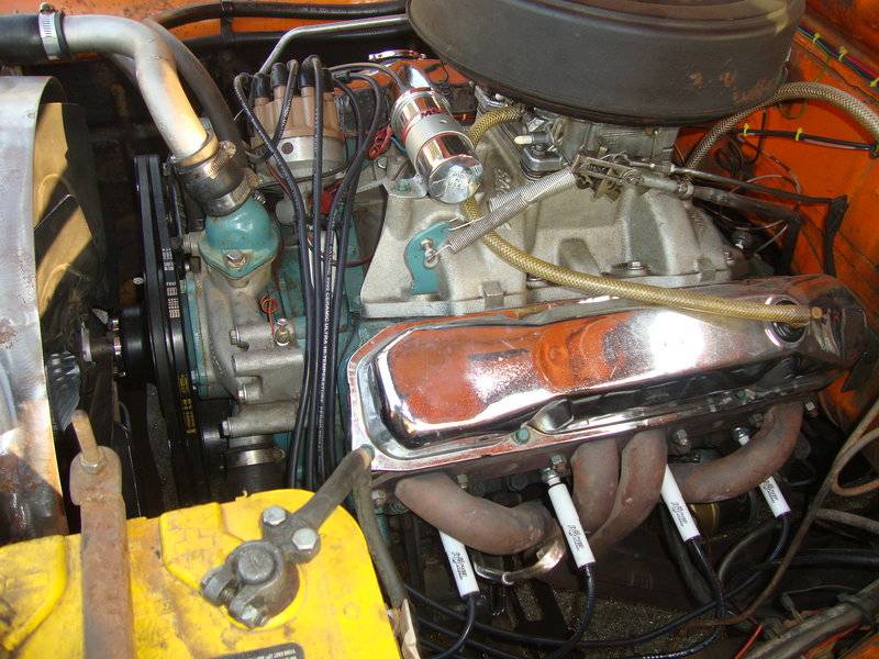

cheap builds , found this rr 383 in a rolled 67 polara 500 in a bone yard . paid $450 for stock looking motor / trans . both were freash , added my own stuff , i can't get pistons n rings for that . got 50k out of it n still going for it .

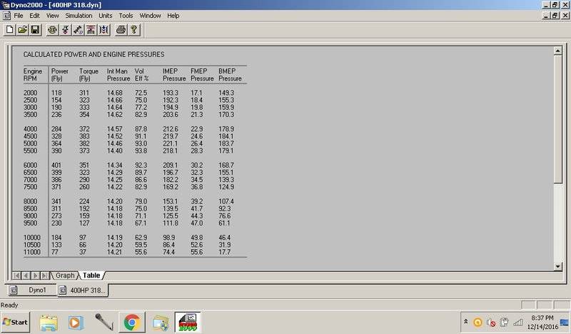

Here's number 2. It's a nasty little 318. 400HP worth. Now, I will be the first to say that Desktop Dyno's numbers are somewhat liberal......however, there is no denying the torque and power curves.
With this engine, we've given it one more compression point to 9.5, upgraded to fully ported 360 iron heads with 2.02 and 1.60 valves. We've swapped to the Mopar 528 solid cam installed straight up. Installed 1.750 primary tube headers running through muffled exhaust and upgraded to a 750 carburetor.
As Jim Laroy is so famous for saying, it's all in the heads. Once you start cranking up head flow on this program, it makes a huge difference.

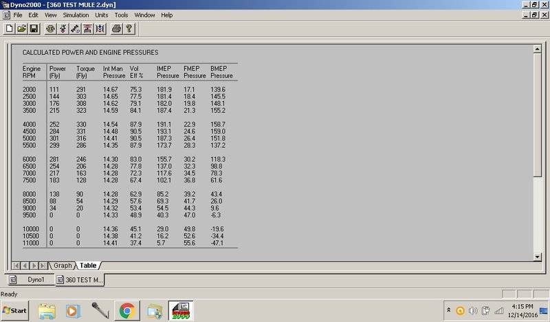

Here is one last one for tonight. Steppin up to a 360. Stock fully ported heads, 2.02 and 1.60 valves. 9.5 compression. 750 carburetor,dual plane intake big tube headers. Comp 275DEH camshaft. This one has more than 300 LB FT from 2000 to 6000 with a peak of 408 LB FT @4000. 382HP @ 5500. Not too shabby for a stock stroke 360.

Has anyone dyno'd, or better yet, gotten any MPH #s at the track for a build that they've run on this program. How was the accuracy?
I've done program builds for a few people here that did claim to have had them dynoed and they said the program was very close.
Of course, that all depends on the dyno and who is operating it. A dyno operator can manipulate the outcome and a stingy or liberal dyno can have effects from one end of the spectrum to the other. The real measure is the drag strip.
