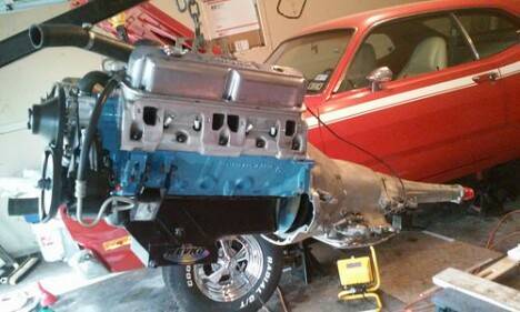

R72 demon that motor looks fast just standing still on stand!:thumbsup: i am in the process of a cam swap myself. Going with oldie but goodie mopar 288/497 purple cam oval track 108 lobe center. Can you give some specs of your masterpiece motor!:steering:
Thanks! It's just a '69 340 block .030" over with KB 243 pistons at zero deck height. Stock forged crank and rods all balanced. 2.02 valve #915 casting U heads with light porting. Old school MP purple shaft 292 duration .508" lift cam with 273 adjustable rockers. Edelbrock Victor 340 intake and a Holley 650 DP carb.
Recently powder coated fabricated valve covers with a crinkle finish.
