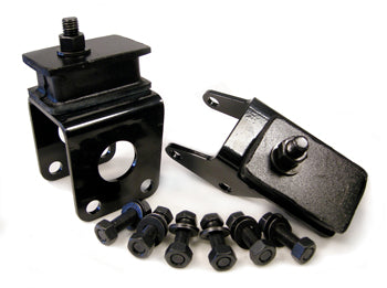

I can only hope they're the right motor mounts. Saw several posts on youtube who used this same kit and had no trouble. This is the kit I got. Says for 6 to 340-360 conversion. Maybe thats' why they look wrong. Thank you very much
pass side slant to v8 conversion is truck mount bracket IIRC. Or really close in dimension
Unless he put a V8 K frame in the car, that looks like the correct engine bracket for the slanty K

the mount looks to be a correct conversion mount. oil pan is deinatley a truck pan though.

these are transdapt s6 tp 360 mounts. the pnes you have look correct.

It's a truck or van pan. The mounts are the same for a truck or car, but the mounting brackets are different. Also, the 340-360 brackets are different from the other LA motors. I was able to bend my 318 brackets to fit my 340 installation in my van. In a A-Body, I think the truck brackets will set the motor to high.
