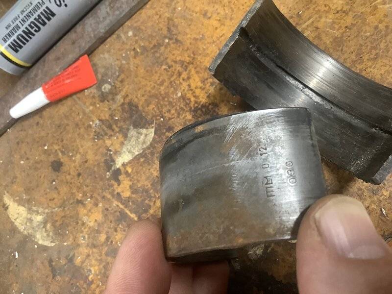

When I pulled the rear main late that summer I found the bearings were badly worn and the seal was in bad shape. The crank seemed polished rather than scored so thinking that i may have put the shells in backwards (hole for oil on the wrong side) I put another set of bearings in. Unfortunately this was all done with the motor still in the car and replacing the oil pan was pretty frustrating. I'd like to say it was the last time I ever had a "rigging fit" but I must have let out a few obscenities loud enough that my little old lady neighbor came over and snuck her head in my garage and asked, in the sweetest voice; "is everything ok honey?" I never felt so bad....

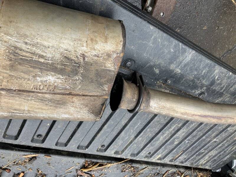

I went ahead and welded the old exhaust anyway. I wanted to see if my jury rigged gun would work and could use the practice anyway.
September 3rd 2012, I had another 500 miles on my relatively "new to me" 340 after the 2nd set of bearing shells. I stopped at a log scaling yard and weighed the car. It's the only time I remember doing that and I need to do it again. It was 3,431 pounds with no one in it. I also took my girlfriend to Port Townsend and even Leavenworth in it but the motor was starting to make the noise and leak oil again. At this point I wrote getting it to the track off for the year and tried to concentrate on hunting the high buck season in the Cascades. That was the year of the Wenatchee Complex Fire and my spot in the Entiat was burning (so were 2 of my back up spots!!) Quitting the cigarettes then wasn't going very well either. It was shaping up to be a pretty crappy year....

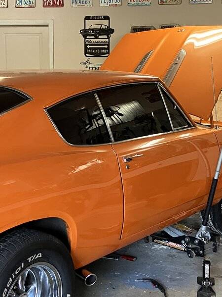

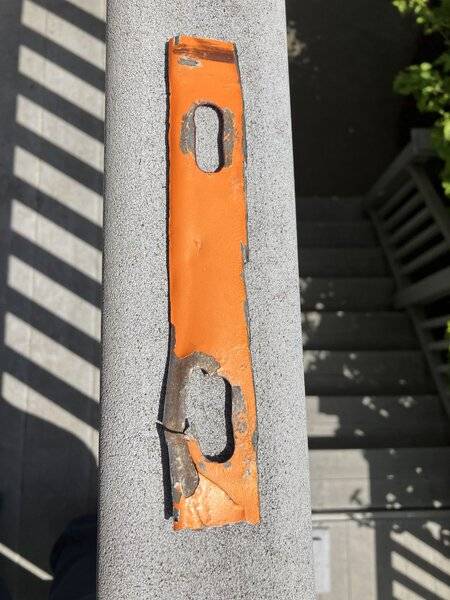

The hood was not going to cooperate any longer. A talented and patient bloke at Seldomridge body shop in Hilliard cut and welded new bits without disturbing the paint on top.
It took a couple months but I couldn’t wait to drive it. I battened down the hinges and registered it without a hood!
