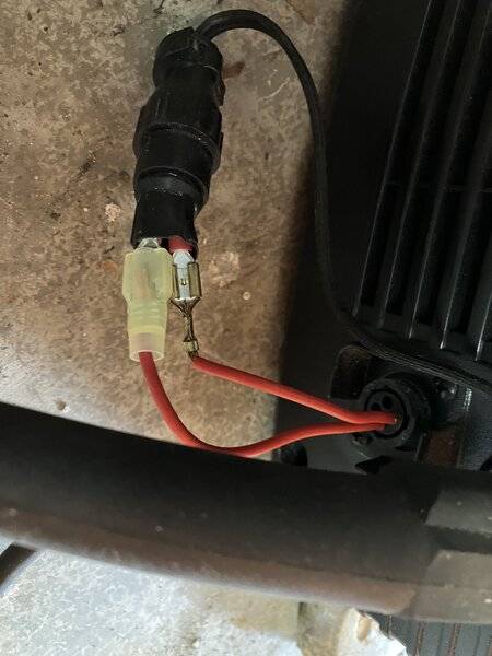

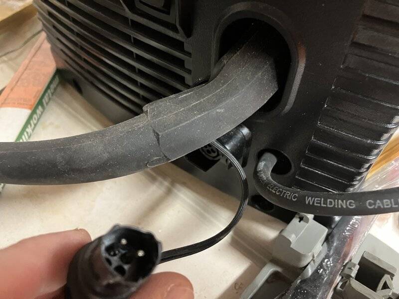

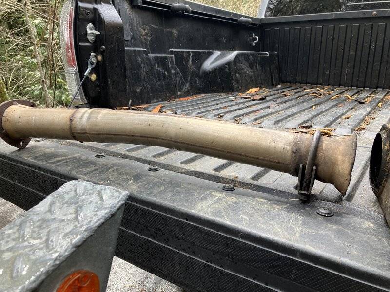

Fast forward today I was thinking about working on my exhaust outlets but the movers bugger’d up the wire feed on my welder. I modified it and it seems to be ok but I’m waiting to hear if or what they’re going to replace…. Then one of the old mufflers broke flush. I think I will just start over with 3” stuff (it’s 2.5” now and pretty spent -see post #24, same mufflers). I never liked how it was put together anyway.
It doesn’t need that bend. I think it could sit more flush to the bottom without it.

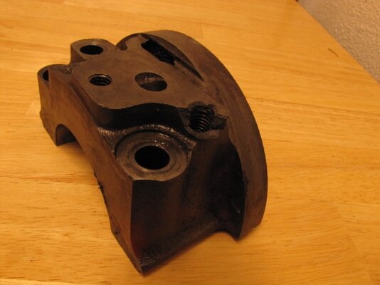

I discovered that the 340 was missing an oil gallery plug in the back by dropping the dipstick down from the oil pressure orifice up top straight down past where the rear main cap would be. I got a lot of flack from Whiteheads cuz they had to order a whole box of plugs to get me one! I also broke one of the bolt holes for the oil pump on that rear cap and had a local fabricator add a stud in there instead. I had to get an oil pan for my application and added a windage tray while I was at it. I got the thing running pretty good by the end of June.

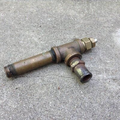

I had a mechanical temperature gauge sending unit so I made this to hook up the heater and get it in the water!!!

no kidding! that's a little more elegant than my jury rig and likely got better readings..... Jez, I ran that funny plumbing for nine years. I had to plane that housing just about every other year. I wonder how these hold up. ??
