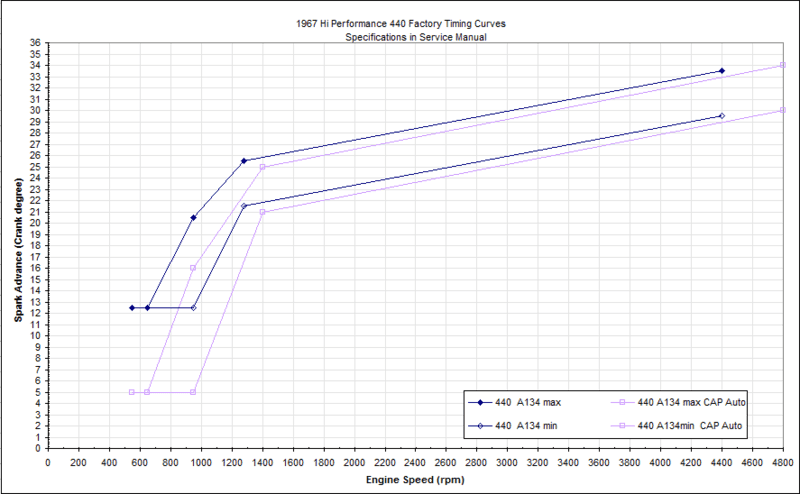

Don't have the hemi curves graphed, but do have the 440 Hi-Po.
This is '67 & below that '68. 0* for the manual cars with CAP.
IIRC '67, both manual and auto non-CAP are 12.5* BTC. CAP auto is 5* and 4 speed is TDC.
I'll try to remember to check the '67 book later to verify.

Oh. Looks like I was wrong. I do have a '67 426 Hemi timing plotted. Don't what spreadsheet its on. LOL

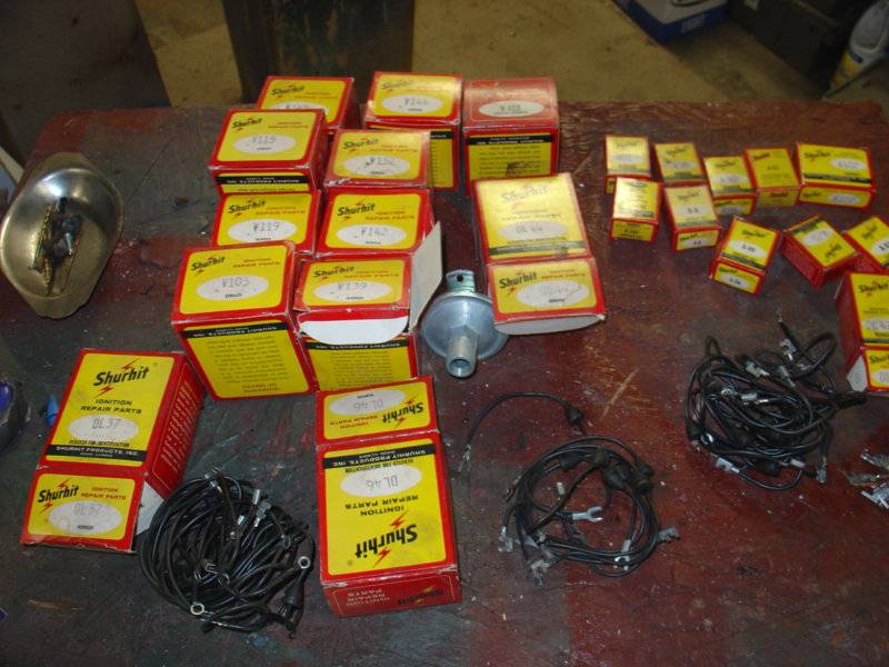

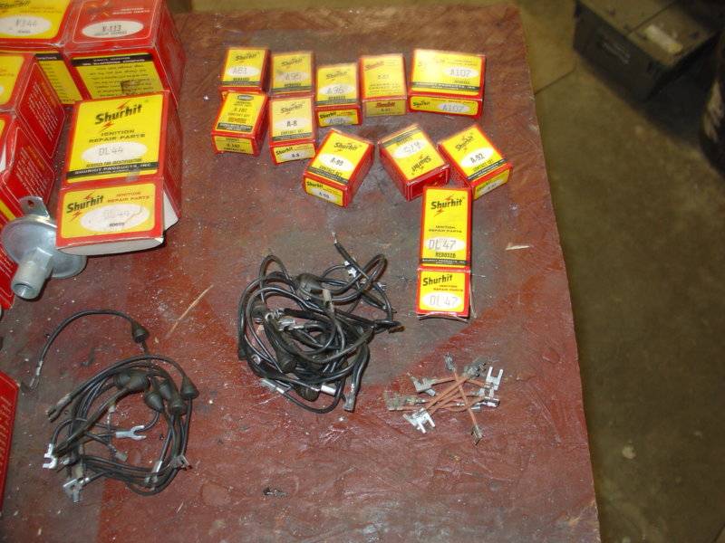

Lol I scored, now with the wife or neighbor it will be a good day! those leads are 20 or more nos!
