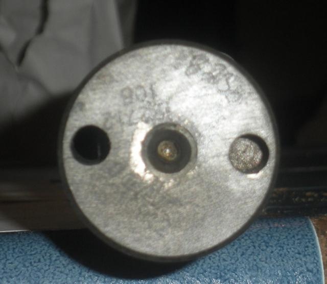

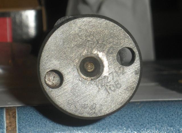

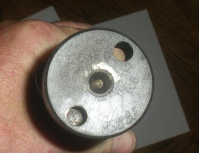

I was surprised to find that the engine detonated more with the Lunati than with the other cams. Yes, the cam I have IS the 316/326 solid.
Mis marked? Here are the numbers on the end of the cam:

Sorta hard to read.
