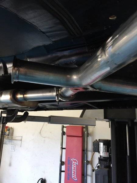

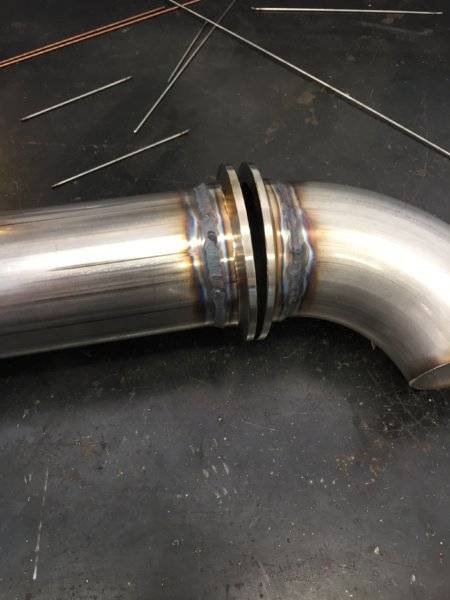

Starting work on exhaust.

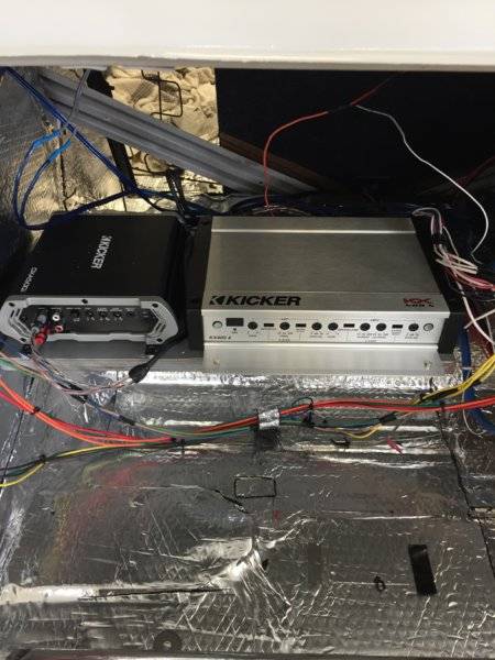

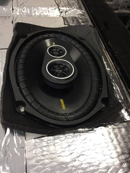

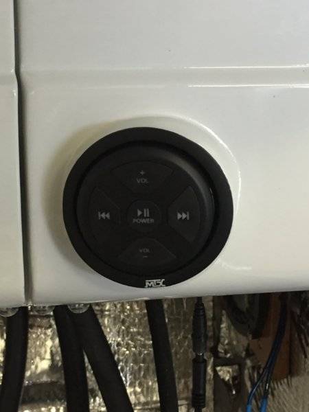

I bought an amp for boats and side by sides that’s waterproof and has Bluetooth. Comes with a corded controller like that too. Decided to run it until I can mount the Redondo I have on the shelf. It works so well, I might just throw the factory radio back in and sell the redondo!!
Looks sharp!
Forgot to mention, if you don’t have something already, I spread the gospel on the F6 split wire loom. It’s easy to work with, and looks much much better than the plastic split loom junk. Pair it with the F4 tape that galvanizes to itself instead of using adhesive, and the harness looks as professional and tidy as it gets

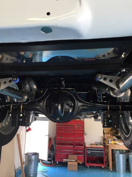

I am taking all the notes... I did get the Dart convertible project The Yard Dart, a Reclamation. '64 Dart GT Ragtop and am really absorbing all of this info. A question or two: Does the four link setup have bump stops? Rubber?

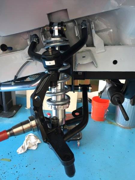

I know that you selected an area of the floor pan to raise in order to provide muffler clearance; could you elaborate on what area you raised, how much and, looking back on it after install, would you do it the same if doing another? What are the wheel/tire size on the front?

A question or two: Does the four link setup have bump stops? Rubber? No bump stops
I know that you selected an area of the floor pan to raise in order to provide muffler clearance; could you elaborate on what area you raised, how much and, looking back on it after install, would you do it the same if doing another? I just eyeball it with the muffler I'm going to use. Anything is better. I've done this on my last several builds. Got tired of exhaust dragging/scraping. What are the wheel/tire size on the front? 18 X 7 Wheels. 225/40/18 Tires.

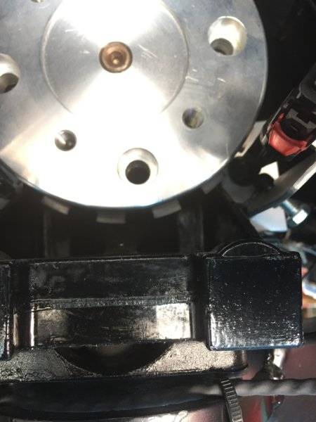

Since 2013 Challengers have IRS there’s not a slip yoke on the trans. Had a custom drive shaft made by Inland Driveline. It came with this nice adapter. You can see the tone ring setup as well.
