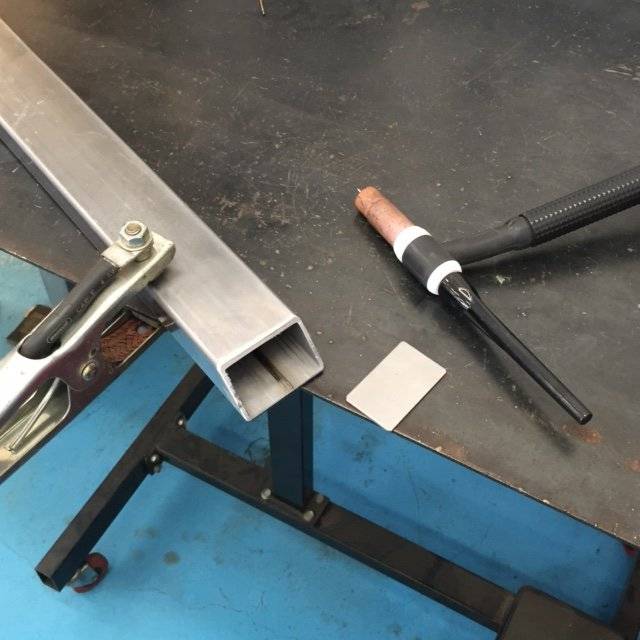

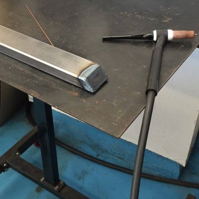

Perches and upper 4 link bar brackets fully welded.

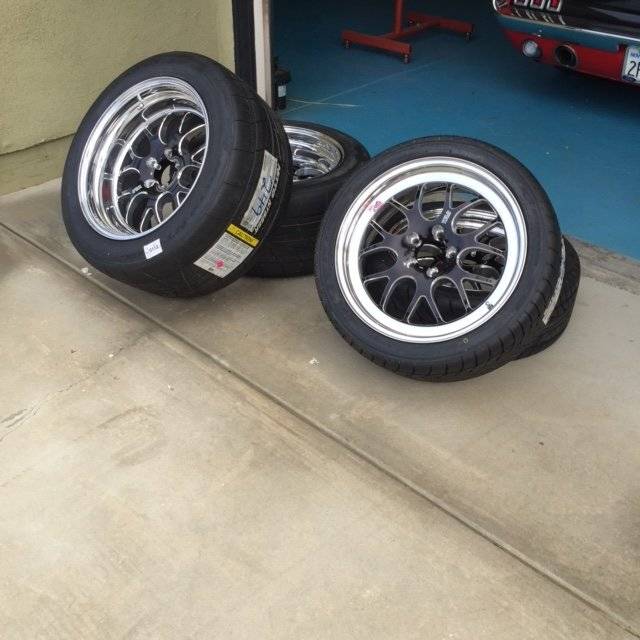

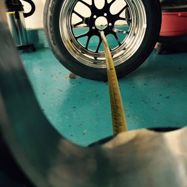

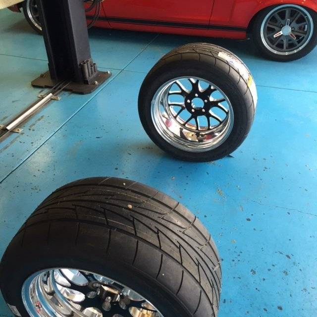

omg. I loved this build before you posted these wheels. I would love those weld wheels. amazing just amazing.I skipped a step here. I ordered my wheels and tires a while back. They came before I ordered the rear end so I could measure accordingly. Weld Racing S77B's. 18" X 7" Front w/225 40 18"s. 18" X 11" Rear w/ 315 40 18"s.View attachment 1714976567 View attachment 1714976569 View attachment 1714976570

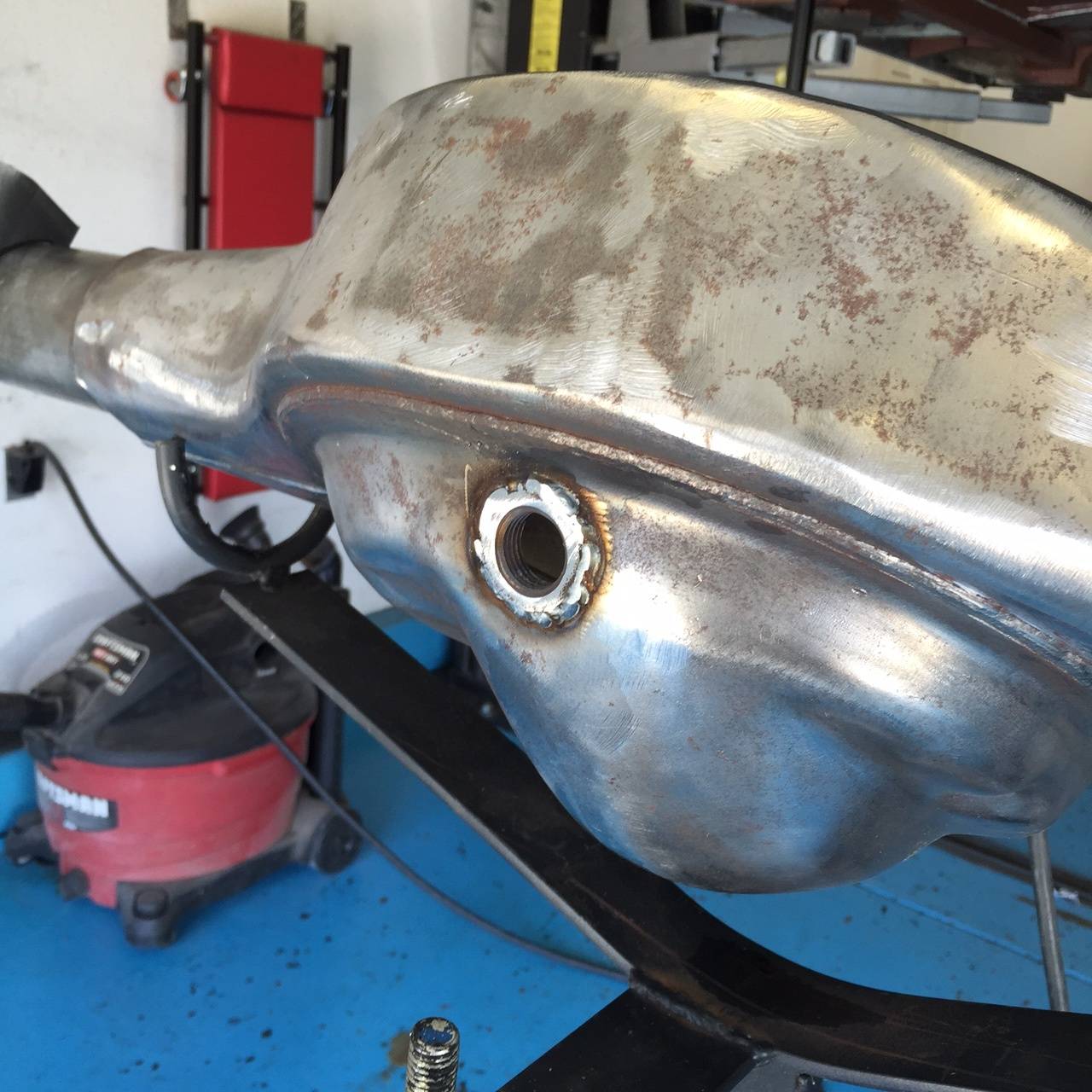

It's definitely 5/16 inverted flare. I think I found a fitting with a long threads.Looks like thats a JIC fitting.... Try a 3/8 NPT to 6AN... Just my 2 cents...
